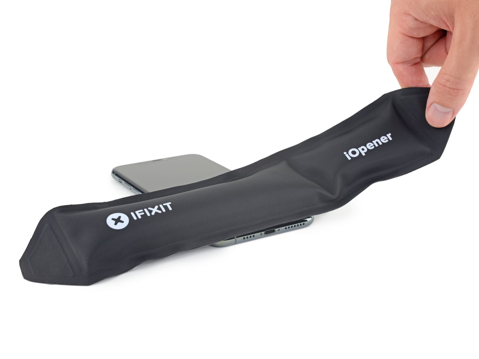

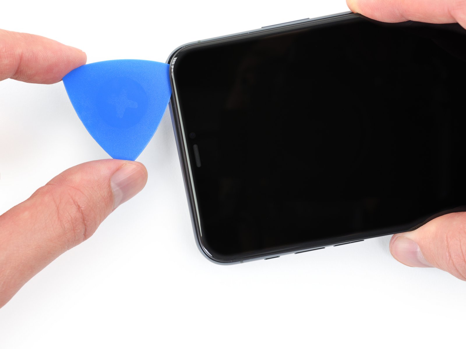

  2. 2. lépés
    Heat the lower edge of the phone

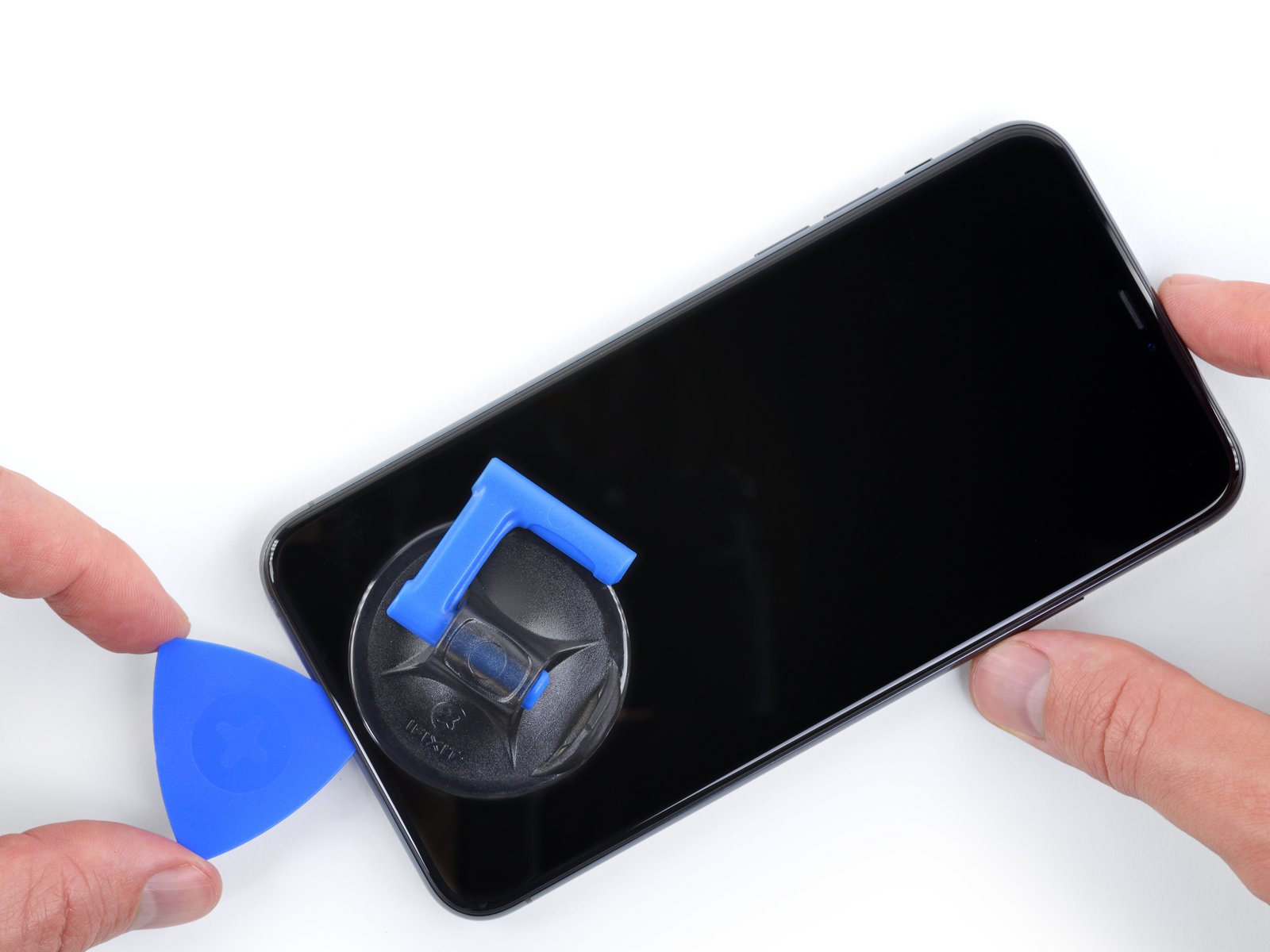

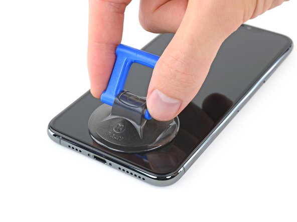

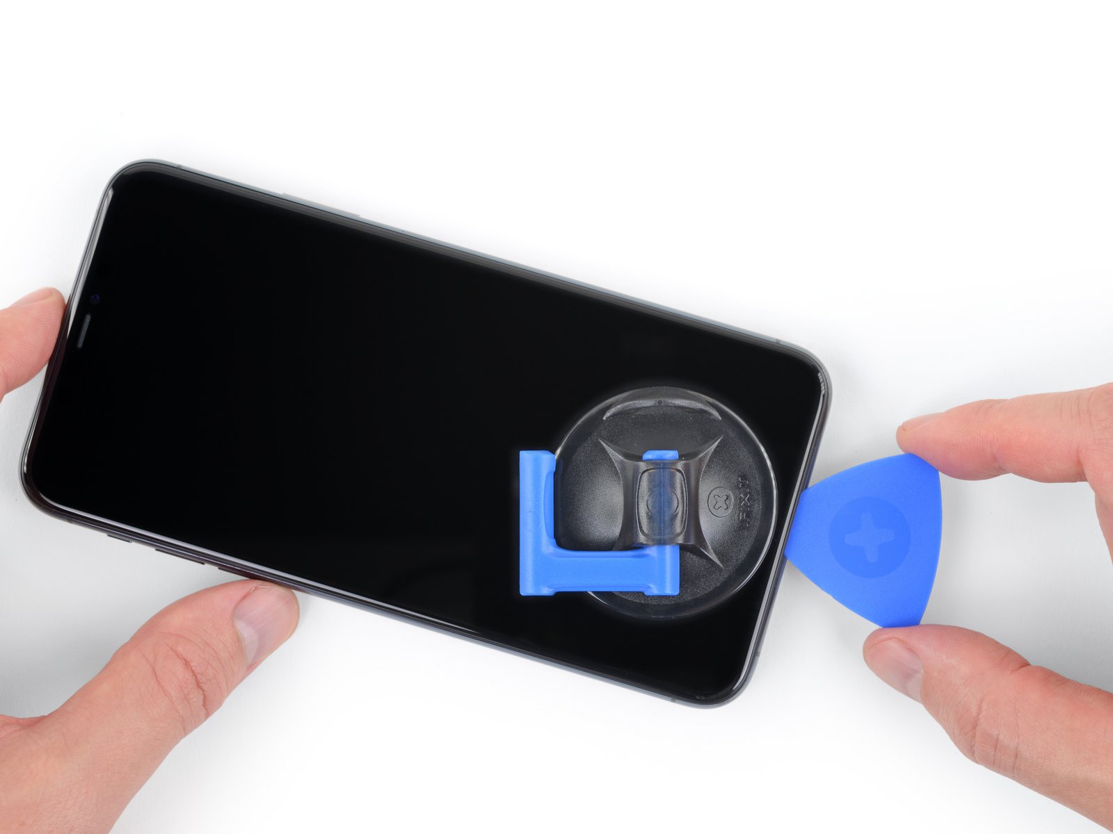

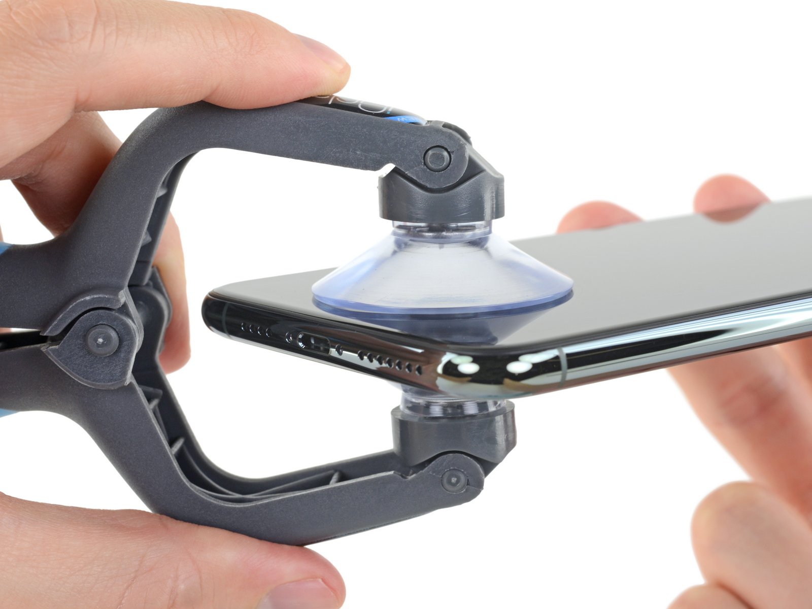

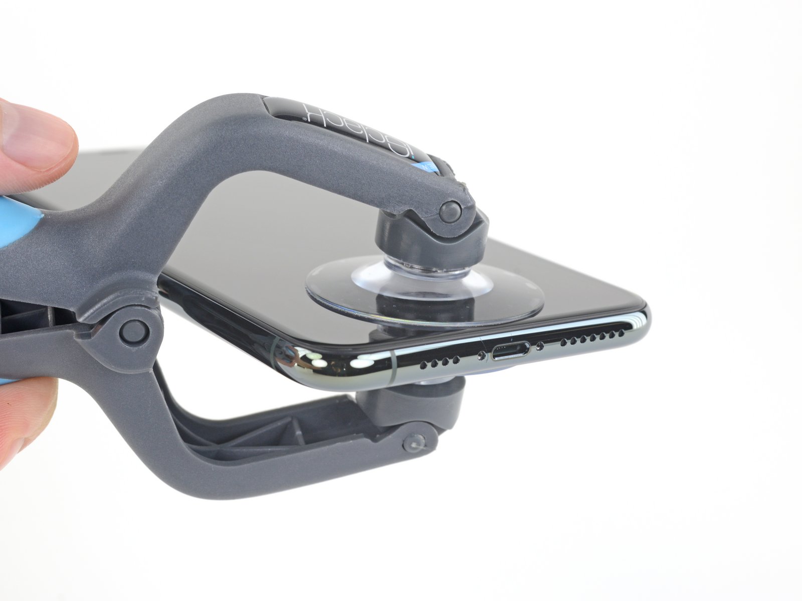

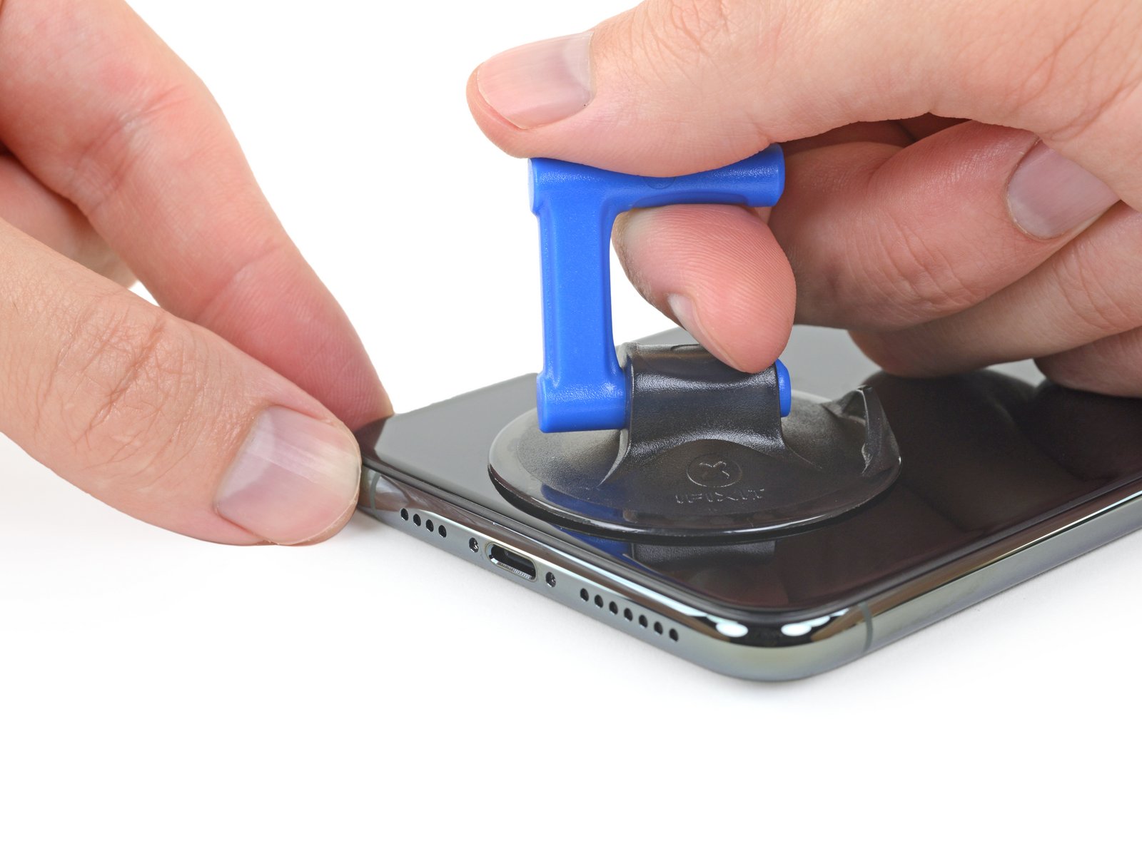

  3. 3. lépés
    Apply suction cup(s)

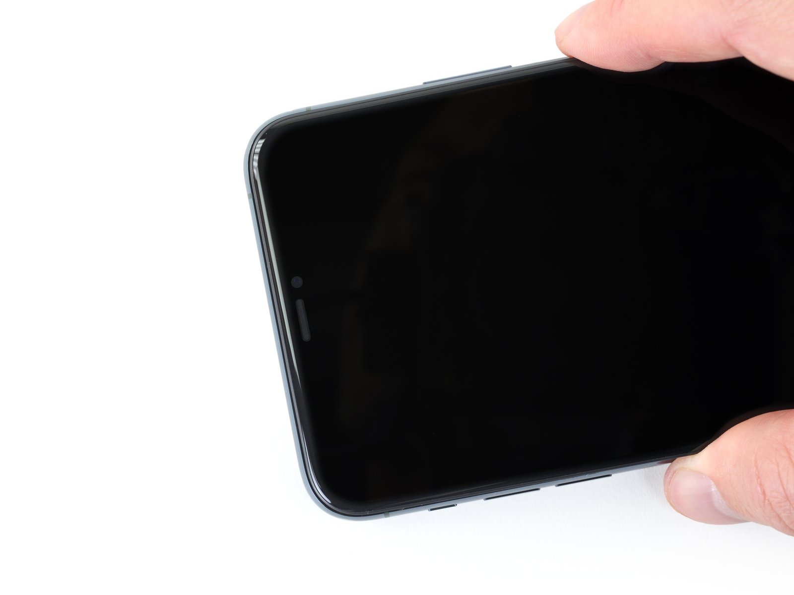

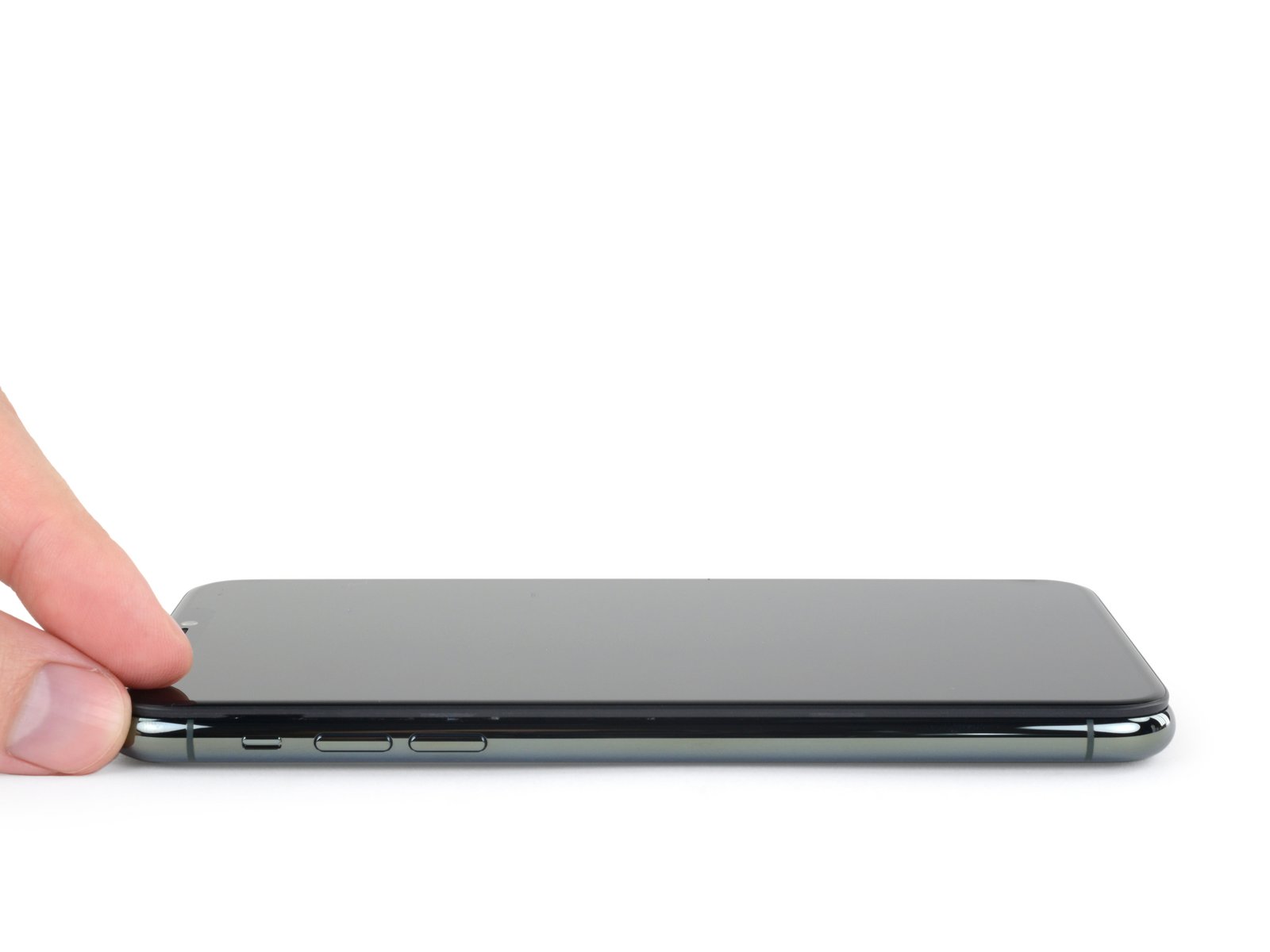

  6. 6. lépés
    Lift the display slightly
  7. 7. lépés
    Separate the screen adhesive

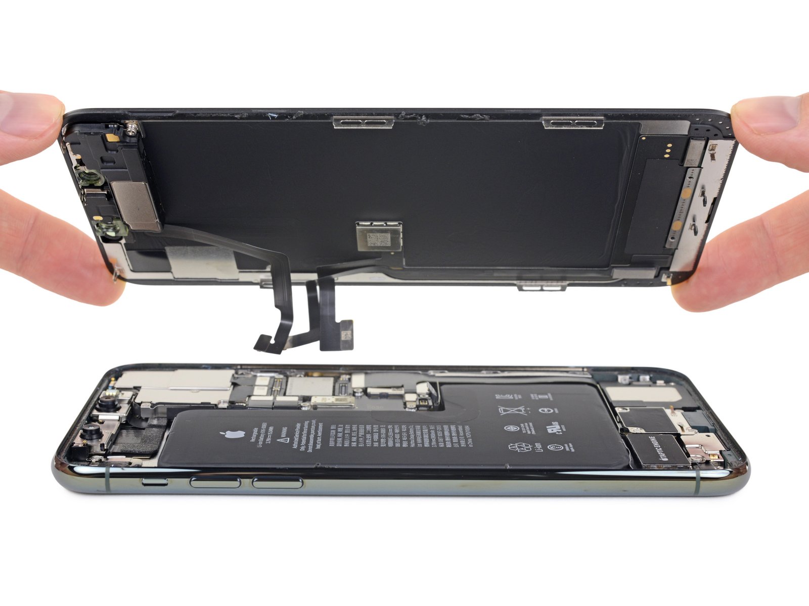

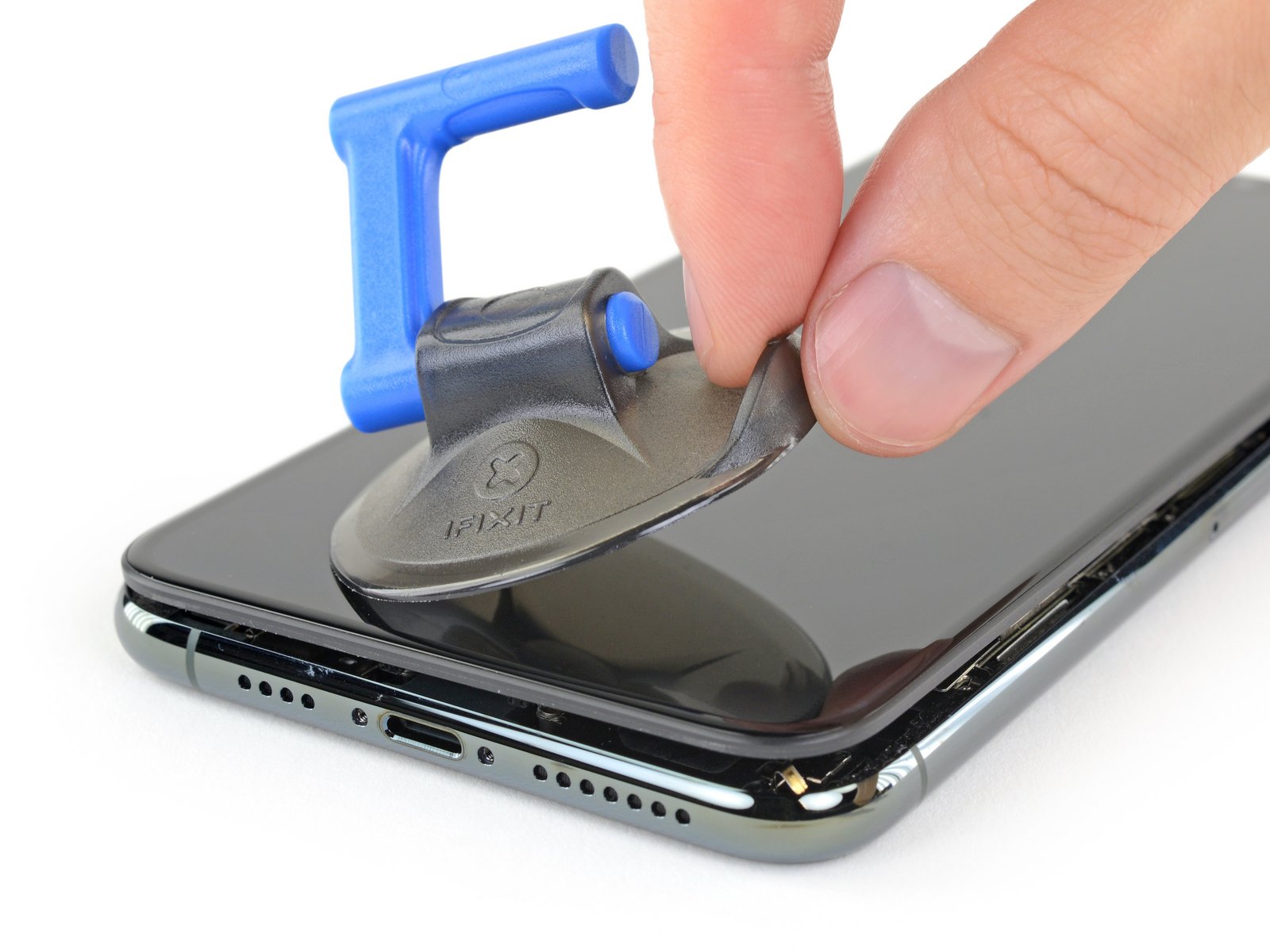

  12. 12. lépés
    Open the iPhone
    Open the iPhone

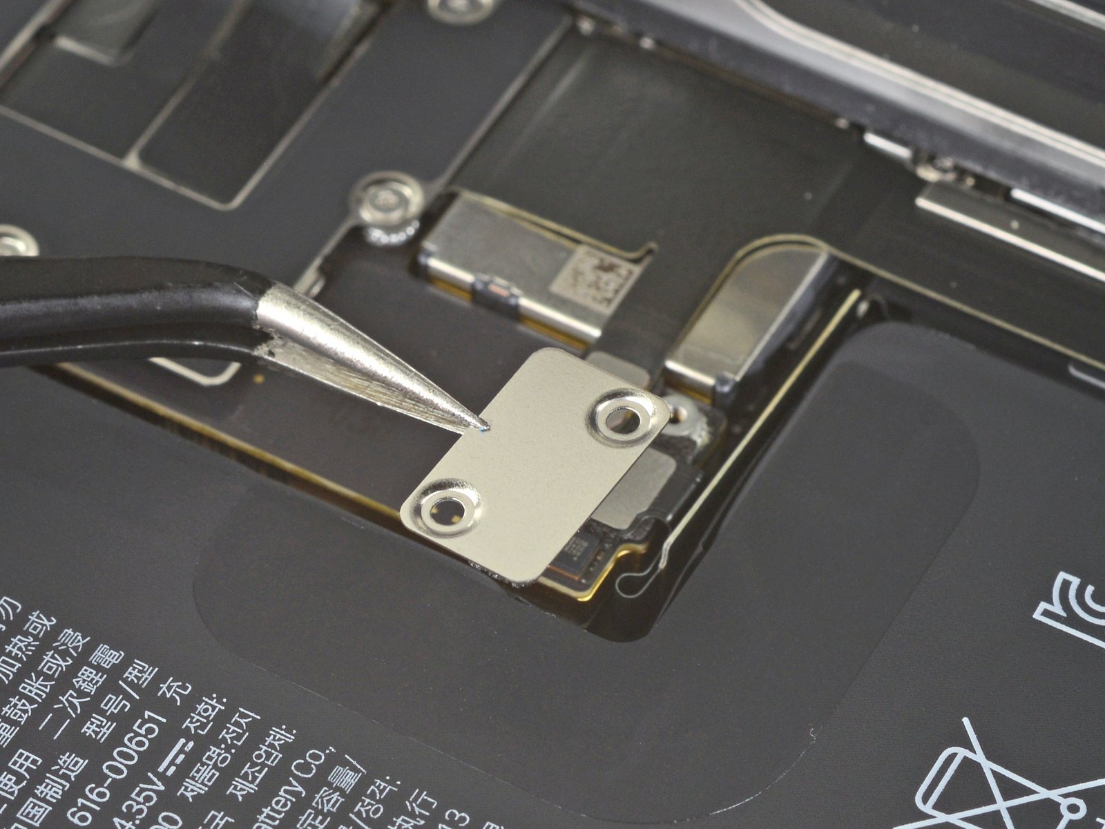

  13. 13. lépés
    Unscrew the battery connector cover
  14. 14. lépés
    Remove the battery connector cover

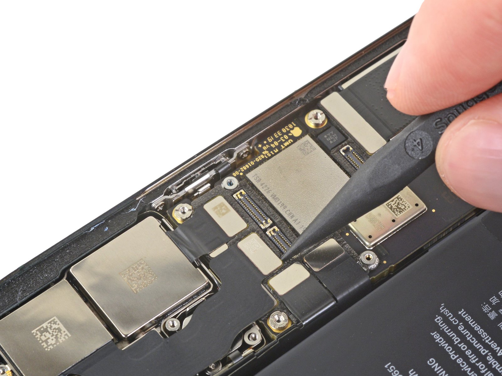

  15. 15. lépés
    Disconnect the battery

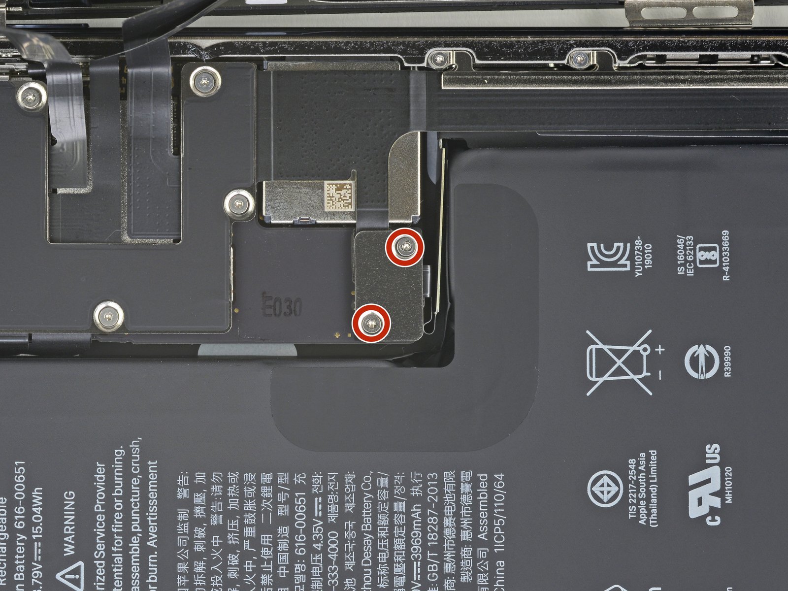

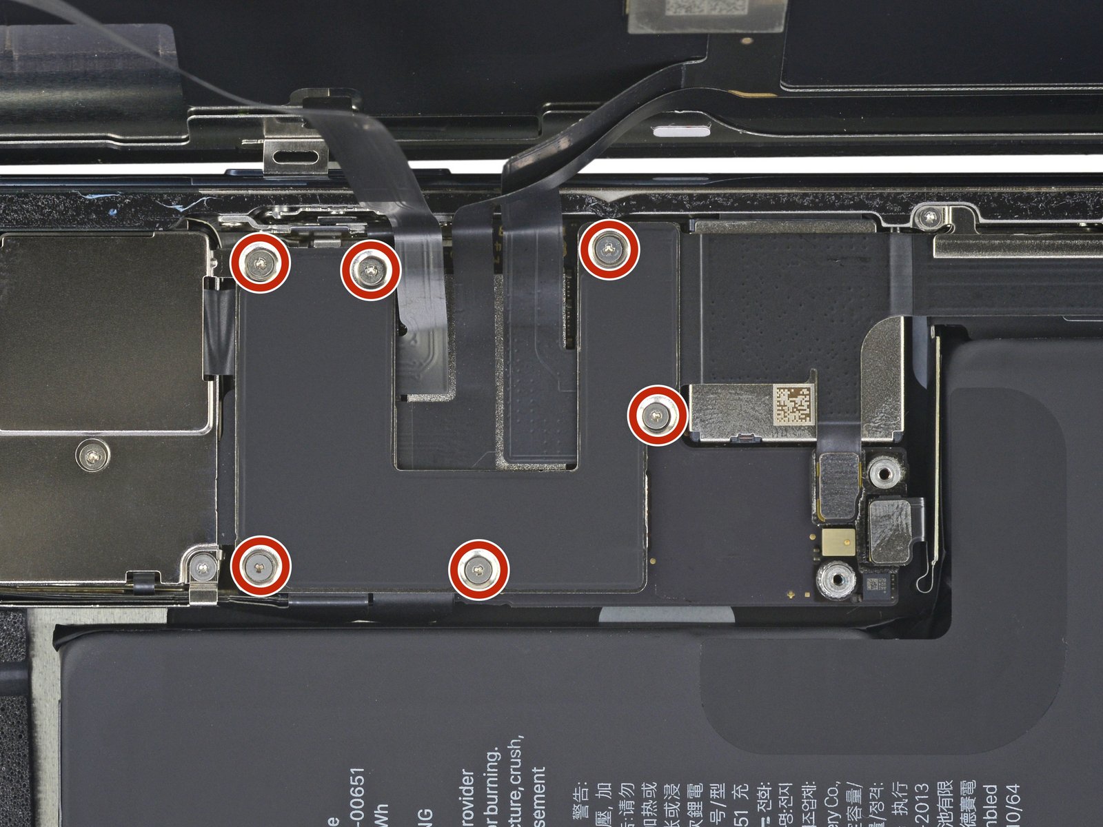

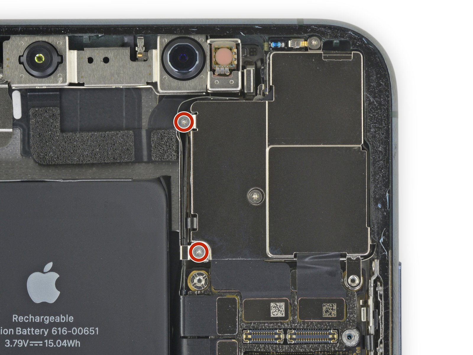

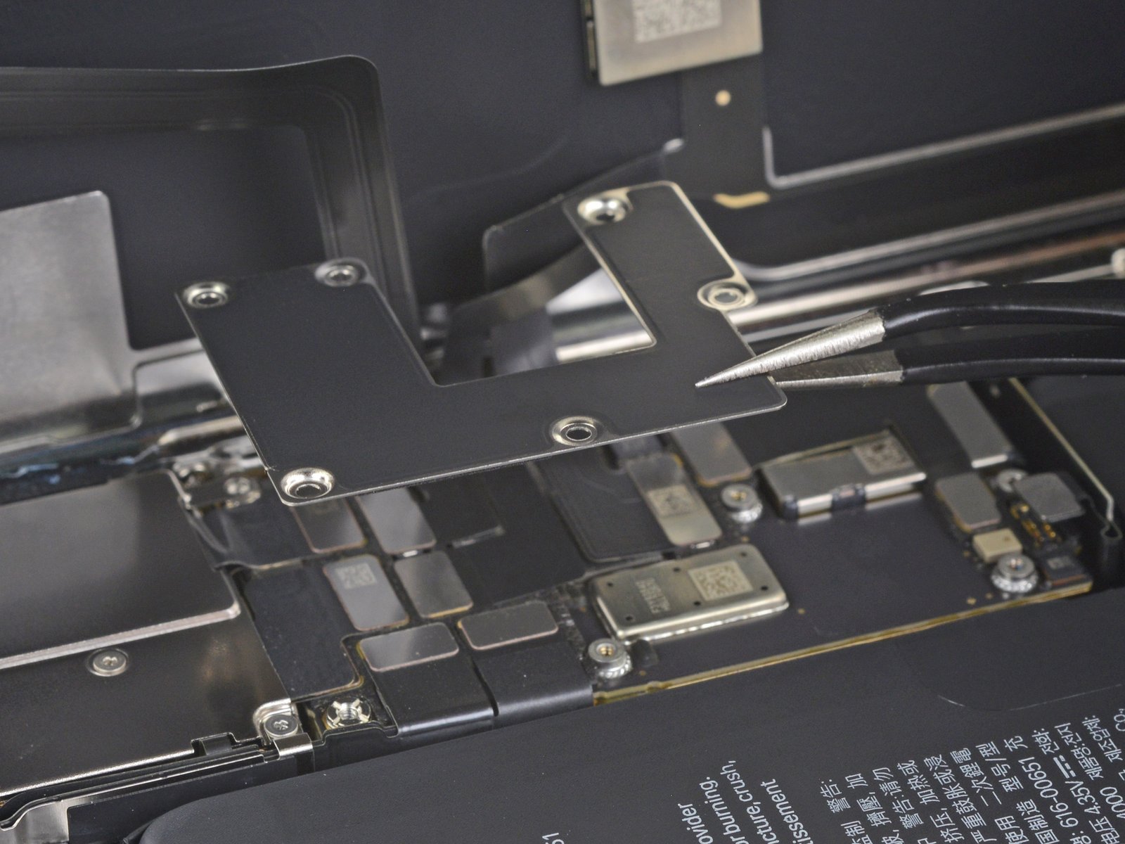

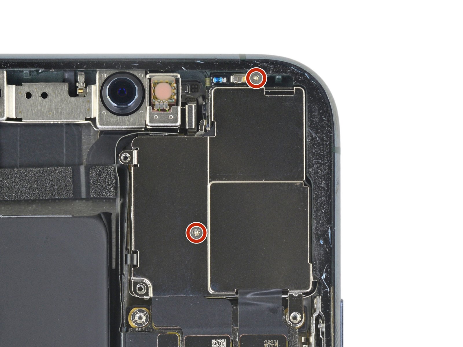

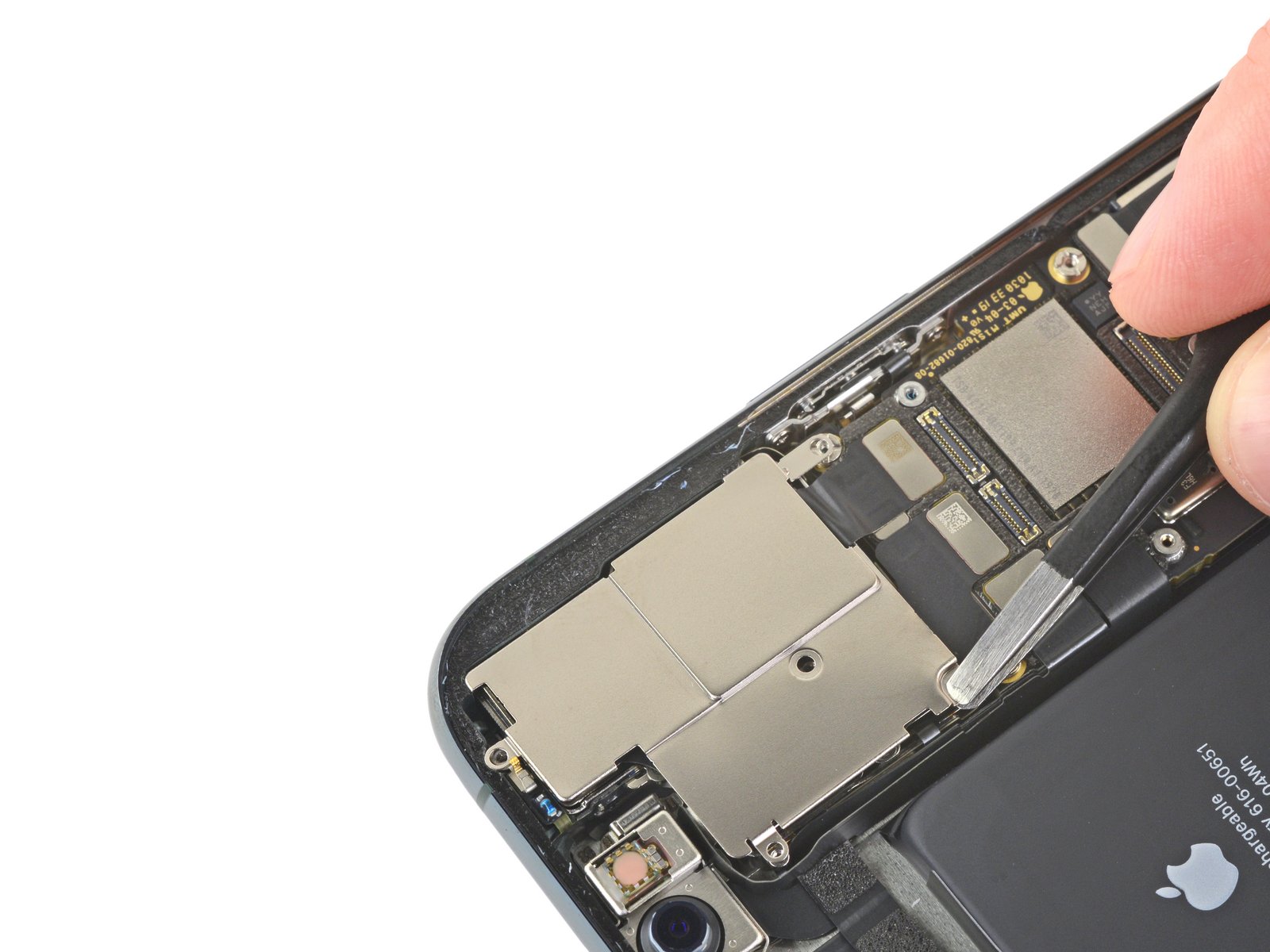

  16. 16. lépés
    Unscrew the logic board cover screws
  17. 17. lépés
    Remove the logic board cover bracket

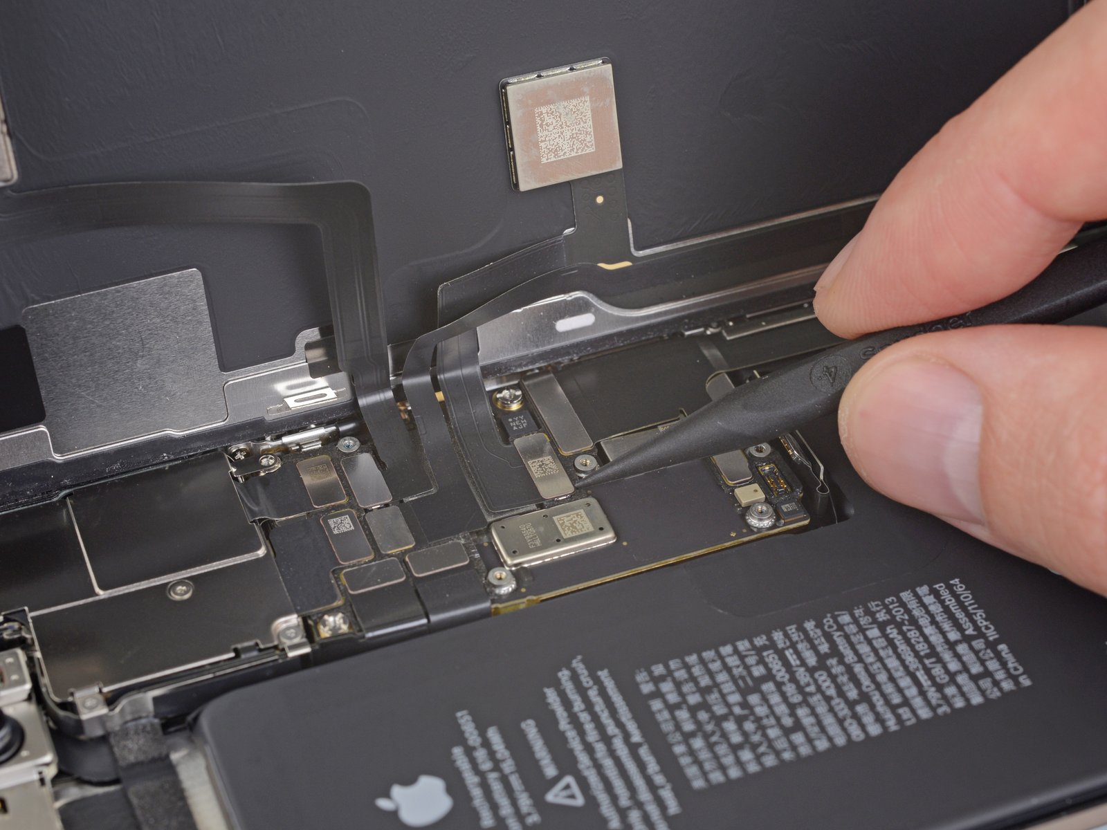

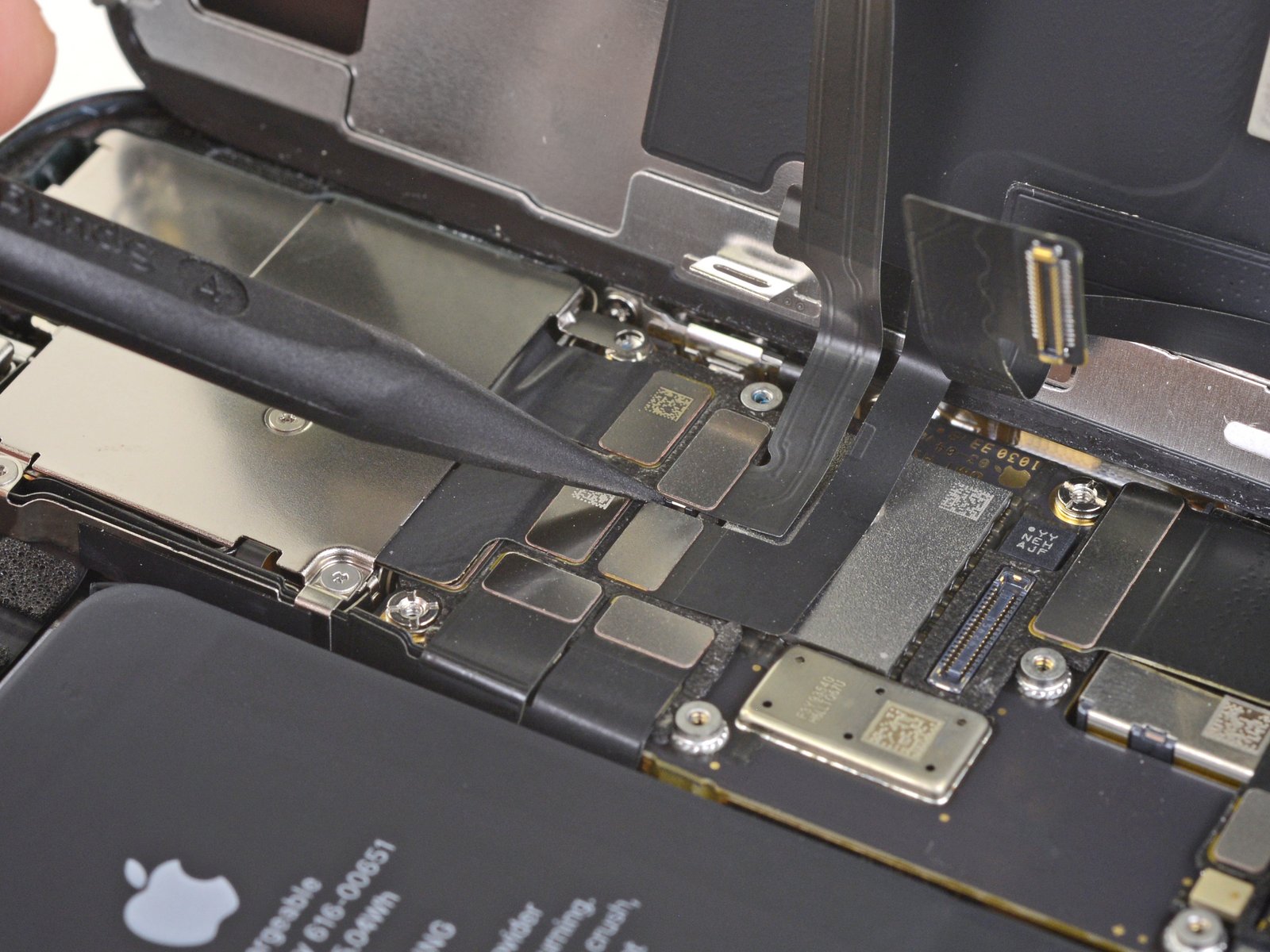

  18. 18. lépés
    Disconnect the OLED display cable
  19. 19. lépés
    Disconnect the front sensors + digitizer
  20. 20. lépés
    Remove the display assembly

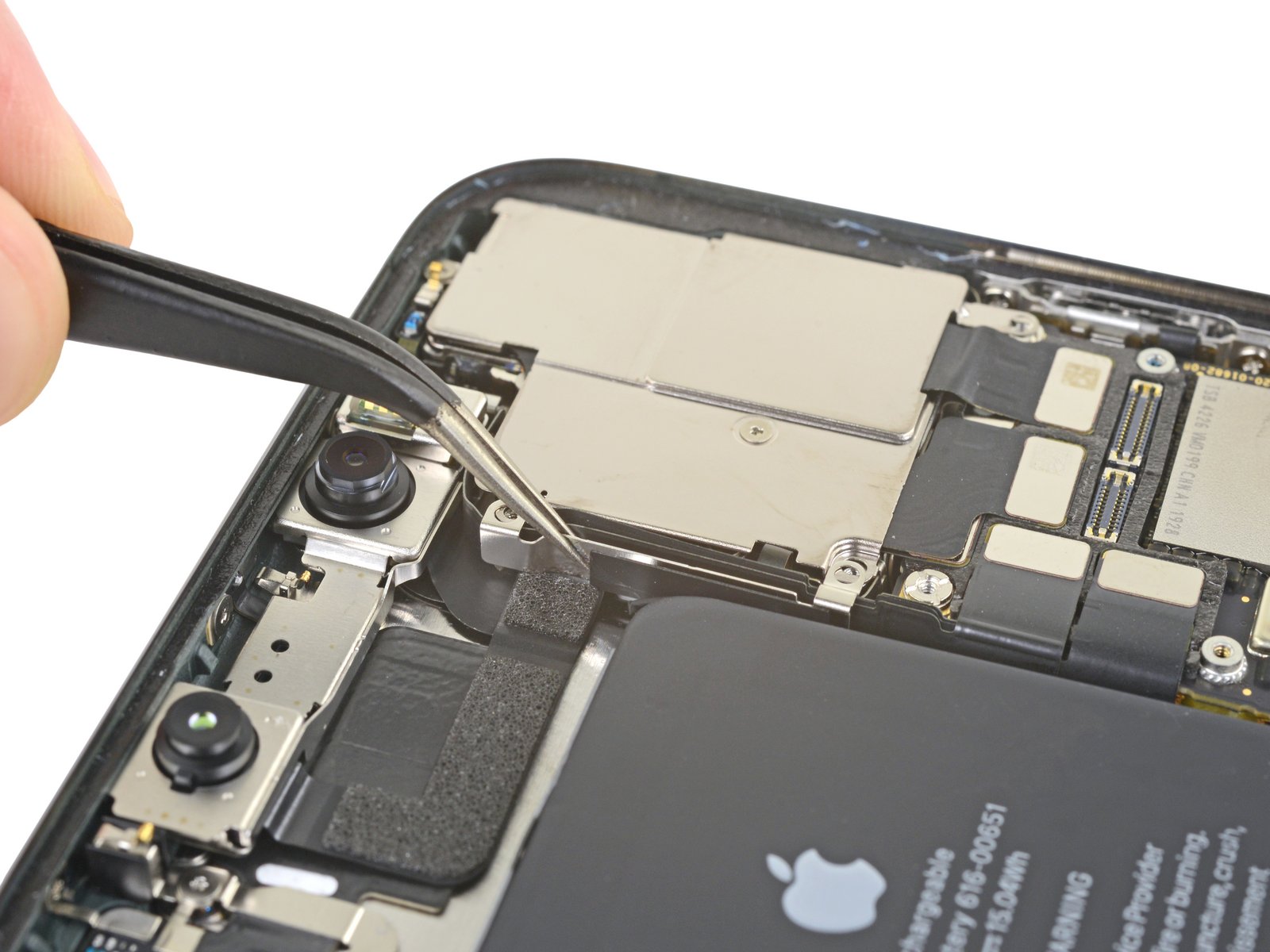

  23. 23. lépés
    Unscrew the rear camera cover
  24. 24. lépés
    Remove the camera cover

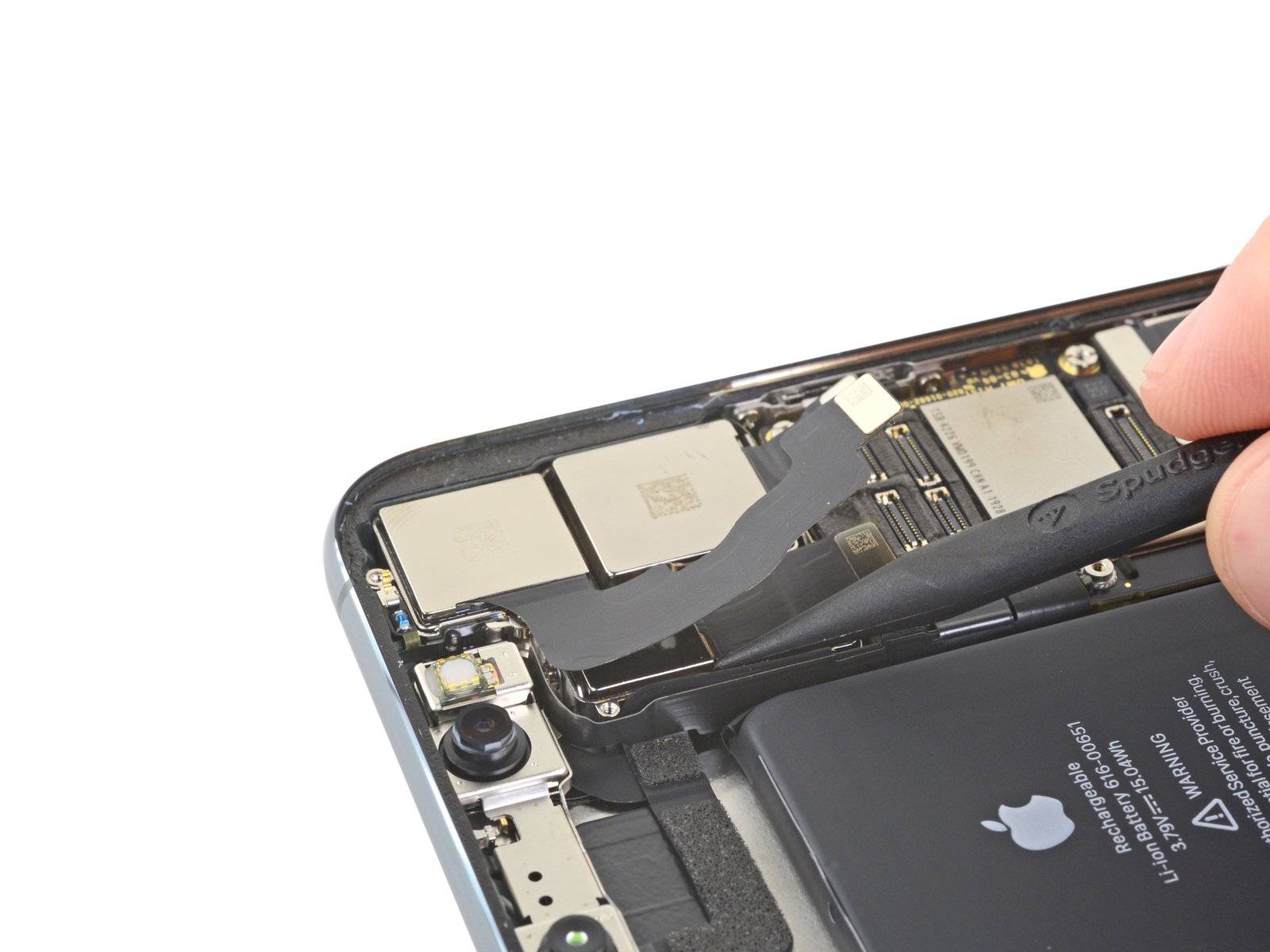

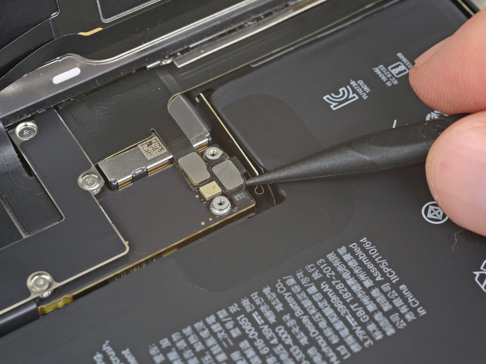

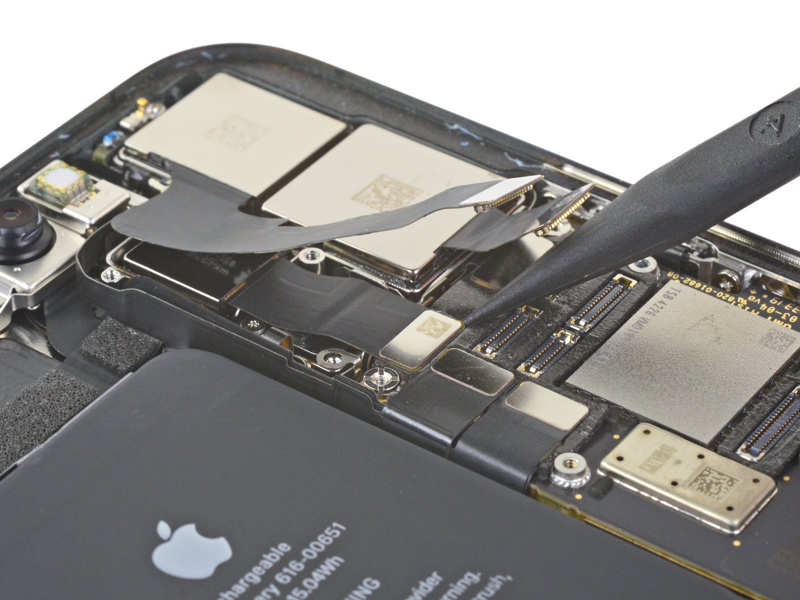

  25. 25. lépés
    Disconnect two cameras
  26. 26. lépés
    Disconnect the third camera

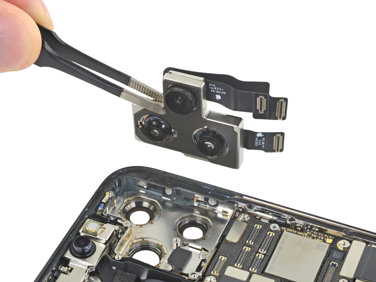

  27. 27. lépés
    Loosen the camera assembly
  28. 28. lépés
    Remove the camera assembly
