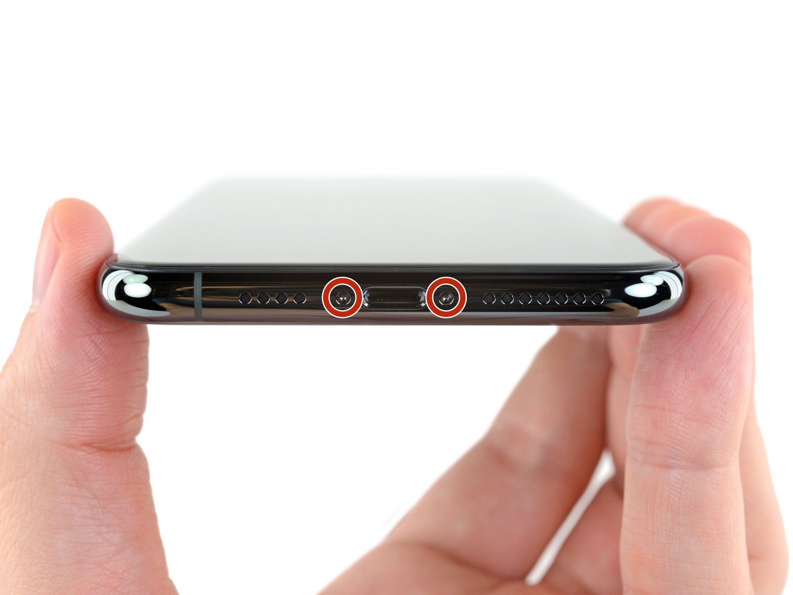

  1. 1. lépés
    Remove the pentalobe screws

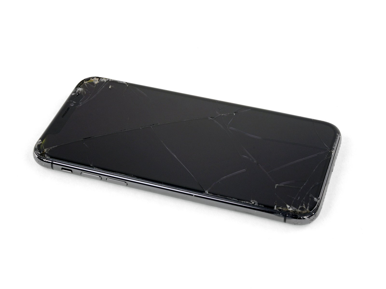

  2. 2. lépés
    Tape over any cracks

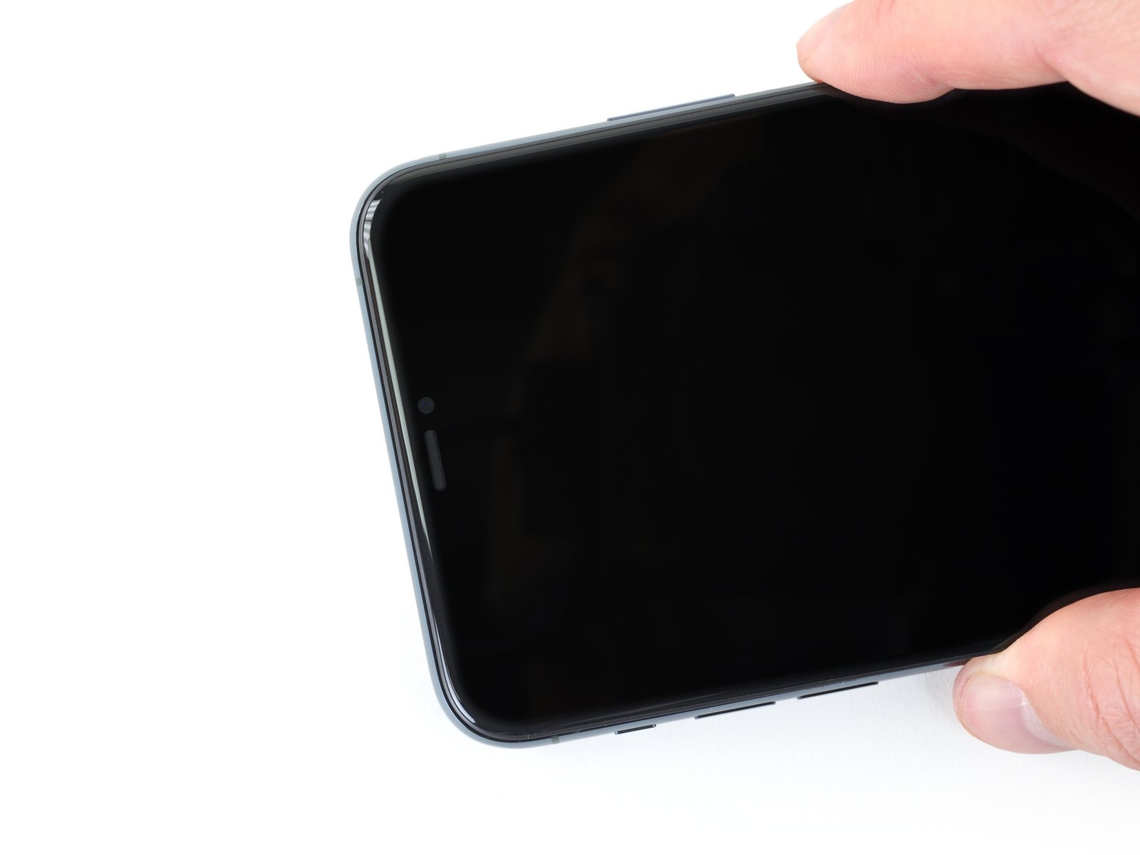

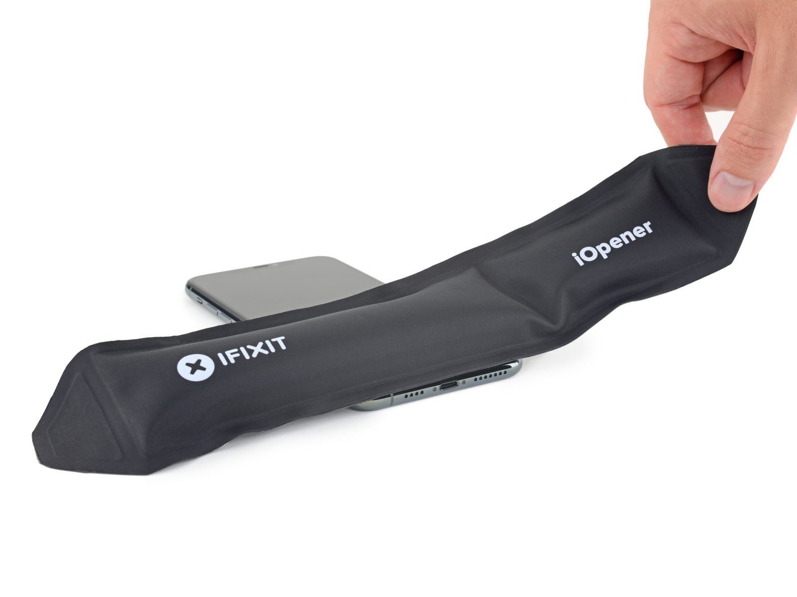

  3. 3. lépés
    Heat the lower edge of the phone

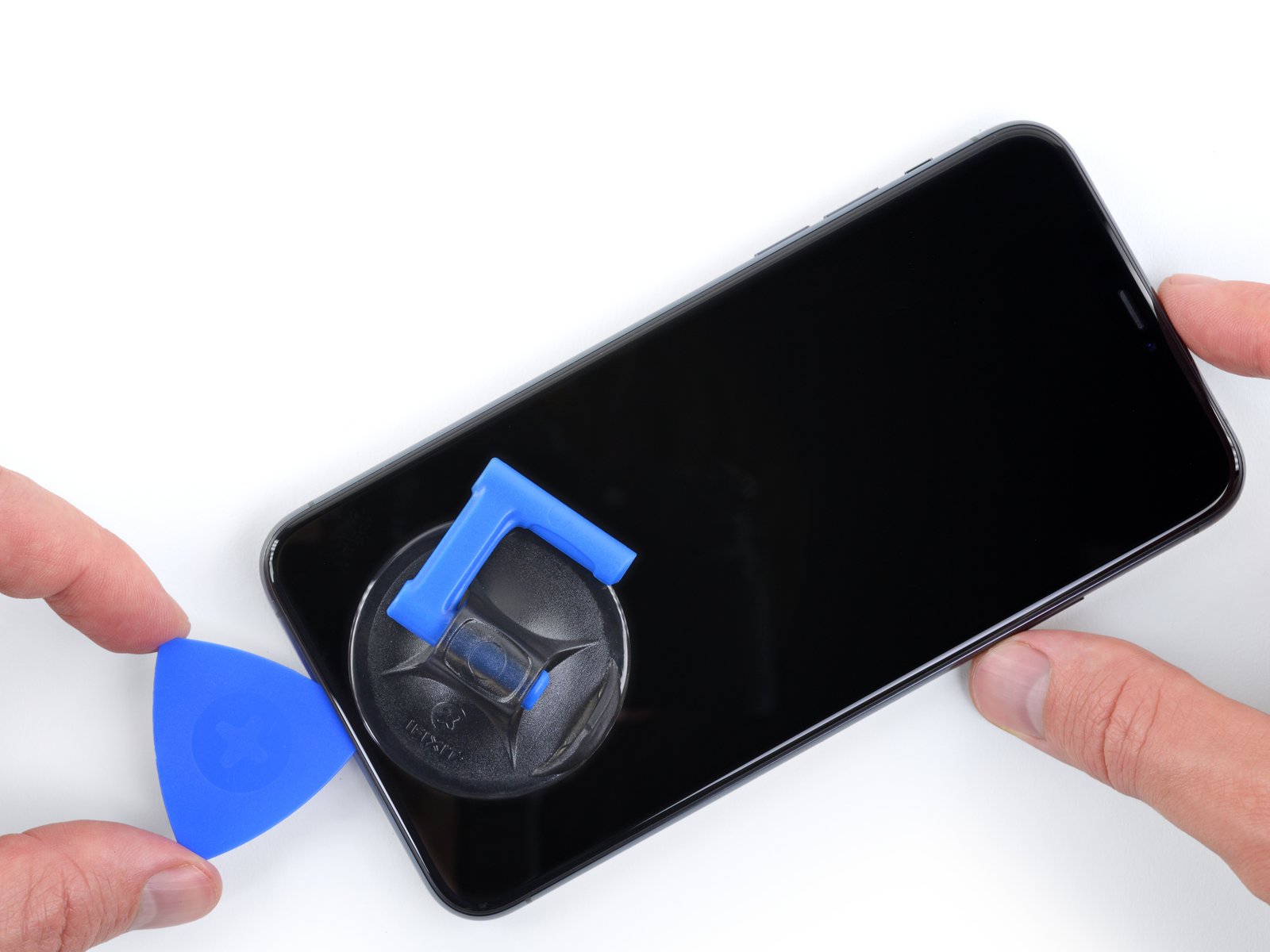

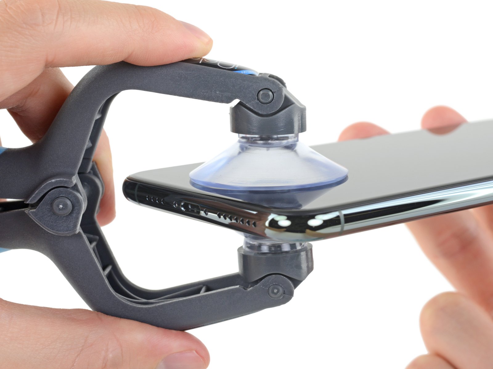

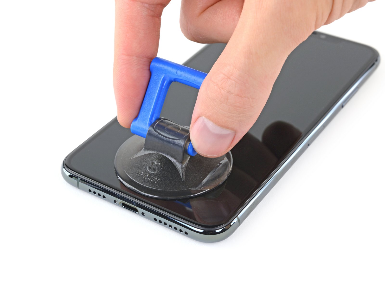

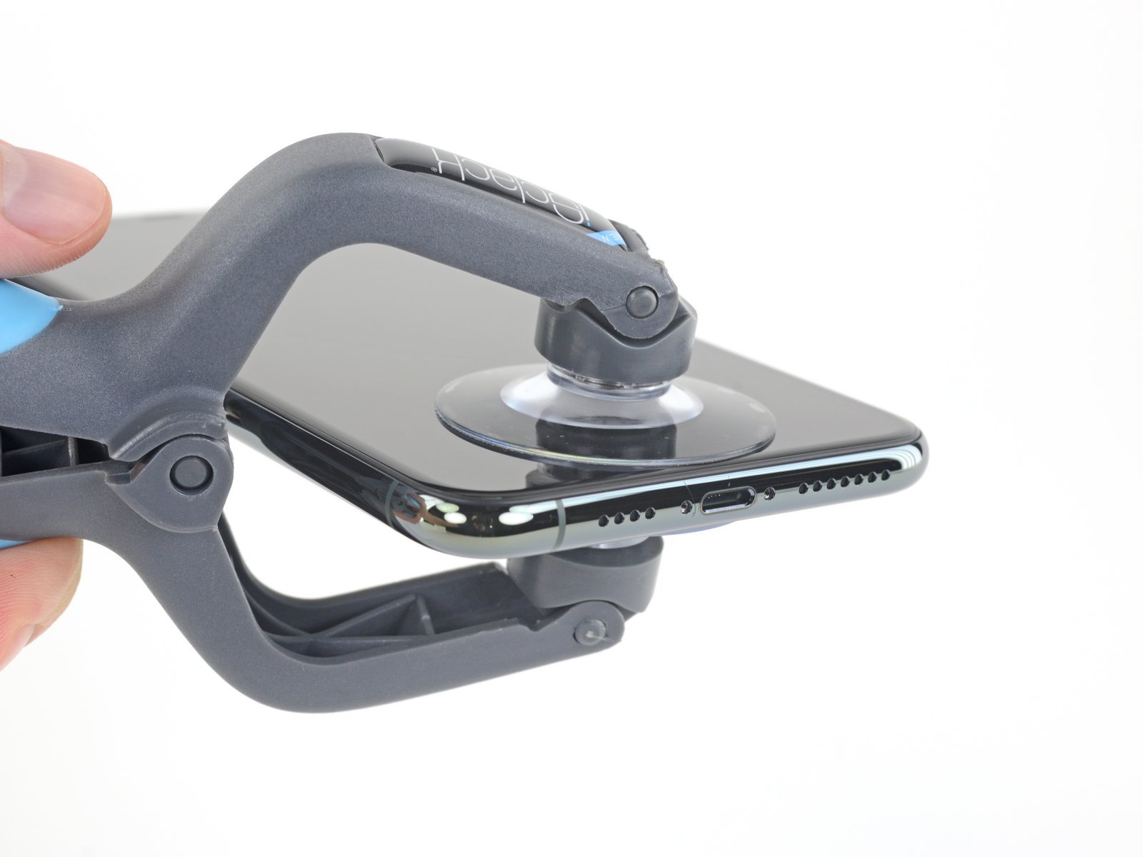

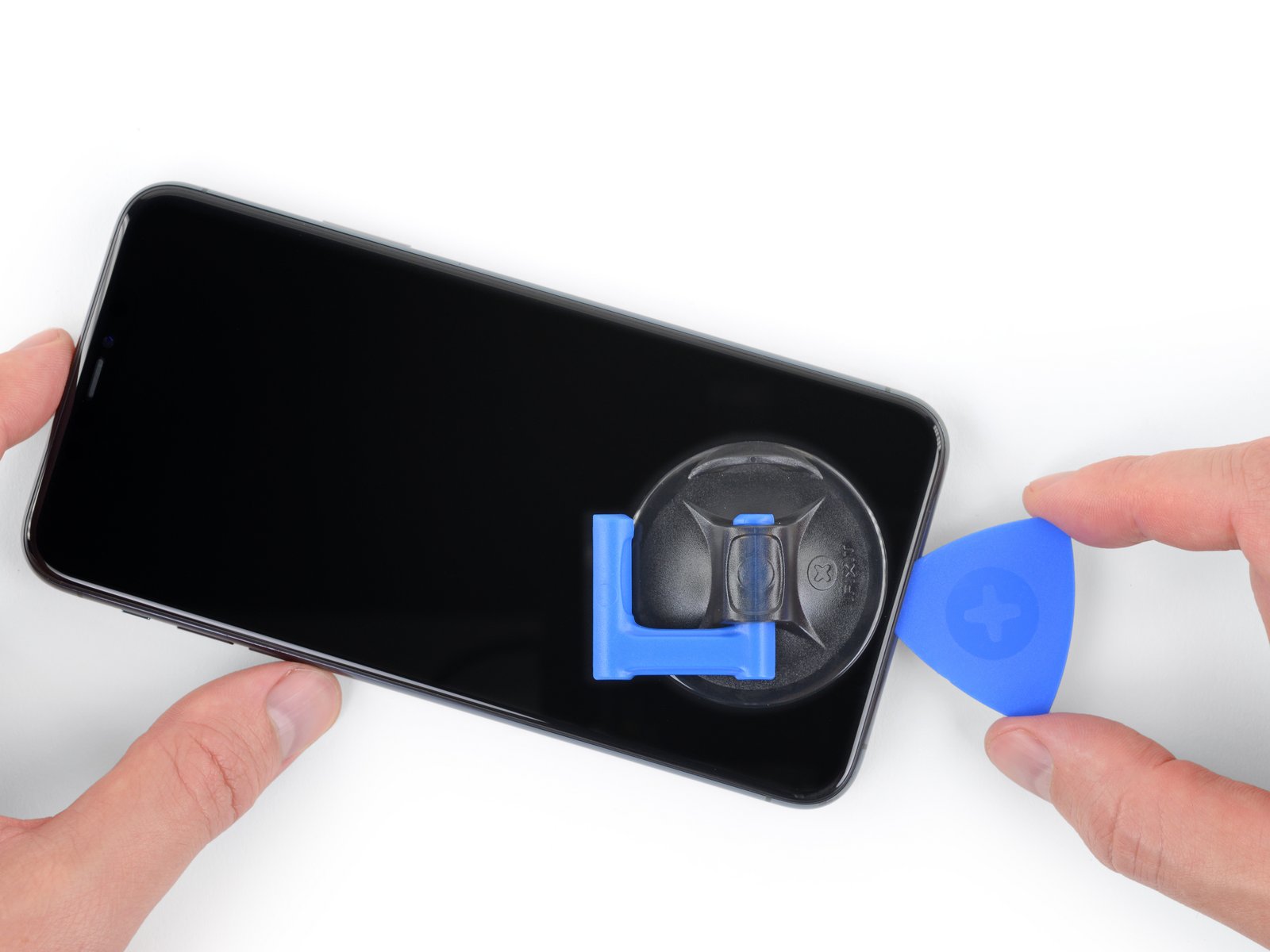

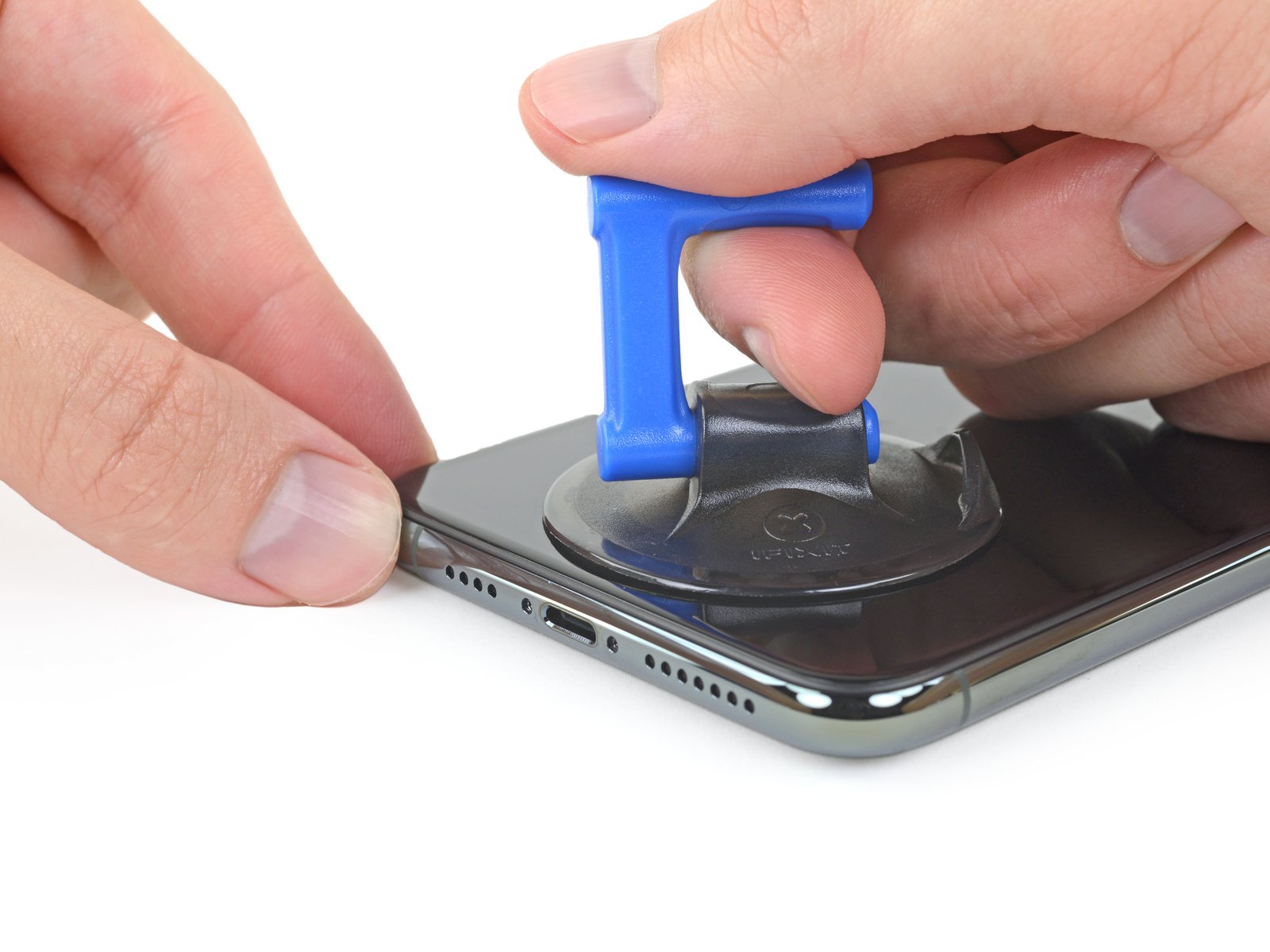

  4. 4. lépés
    Apply suction cup(s)

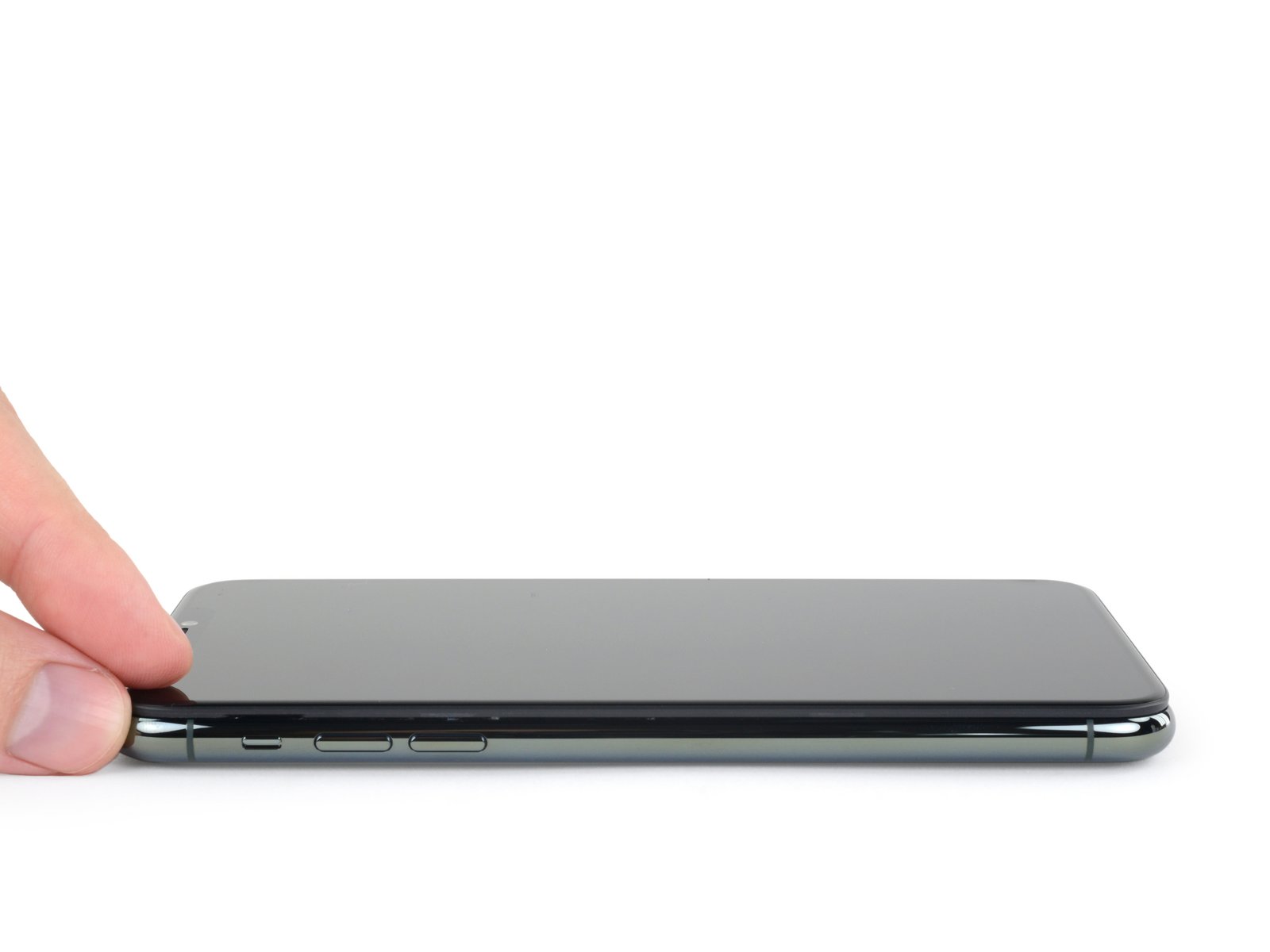

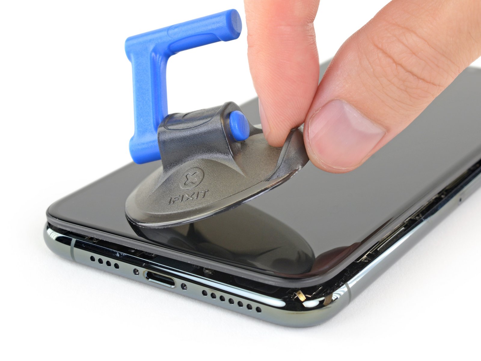

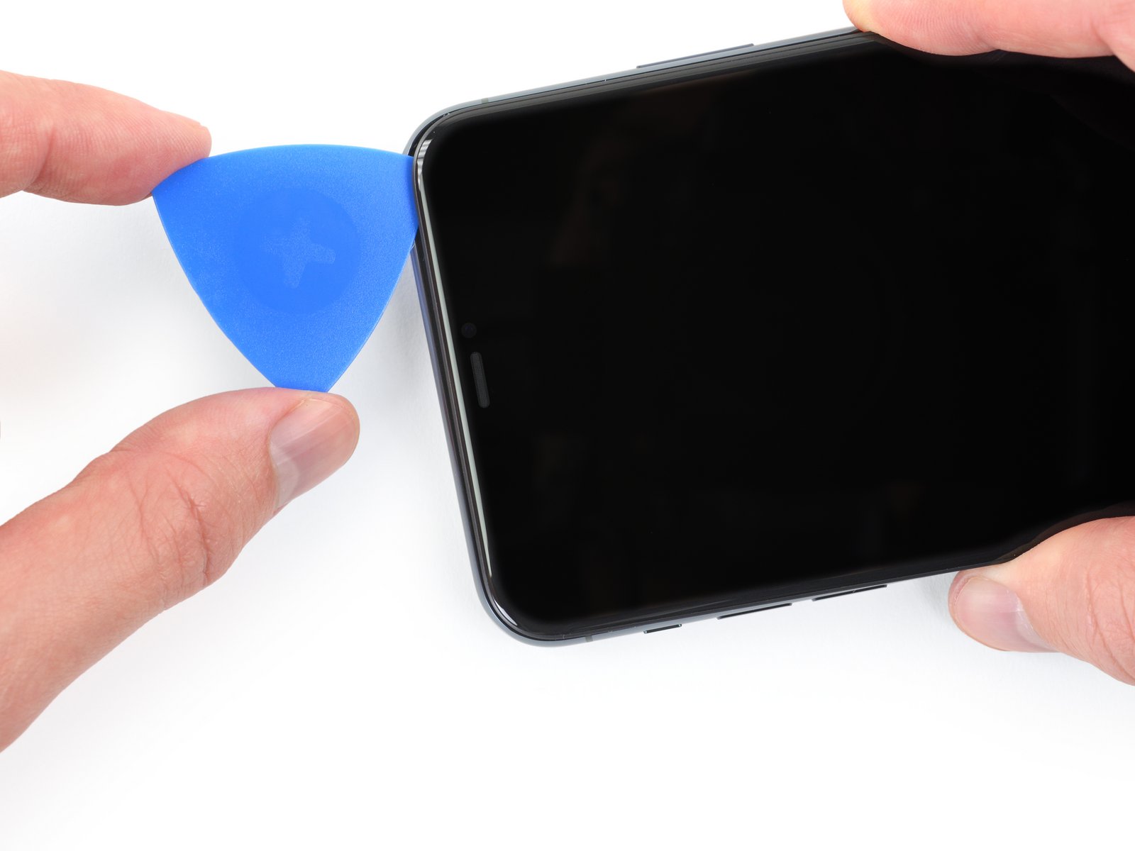

  7. 7. lépés
    Lift the display slightly
  8. 8. lépés
    Separate the screen adhesive

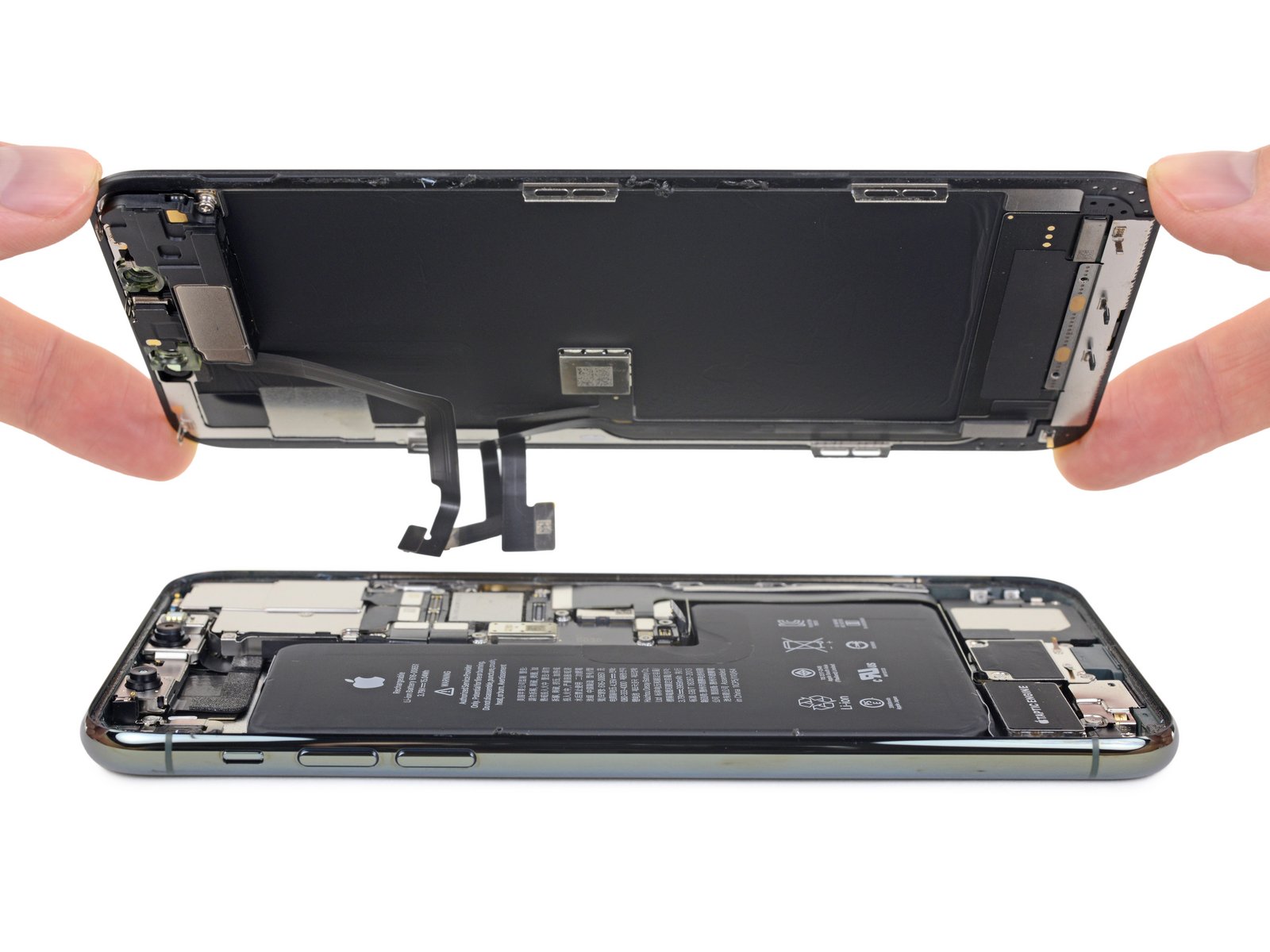

  13. 13. lépés
    Open the iPhone
    Open the iPhone

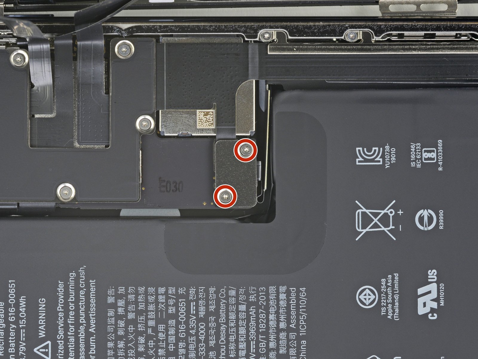

  14. 14. lépés
    Unscrew the battery connector cover

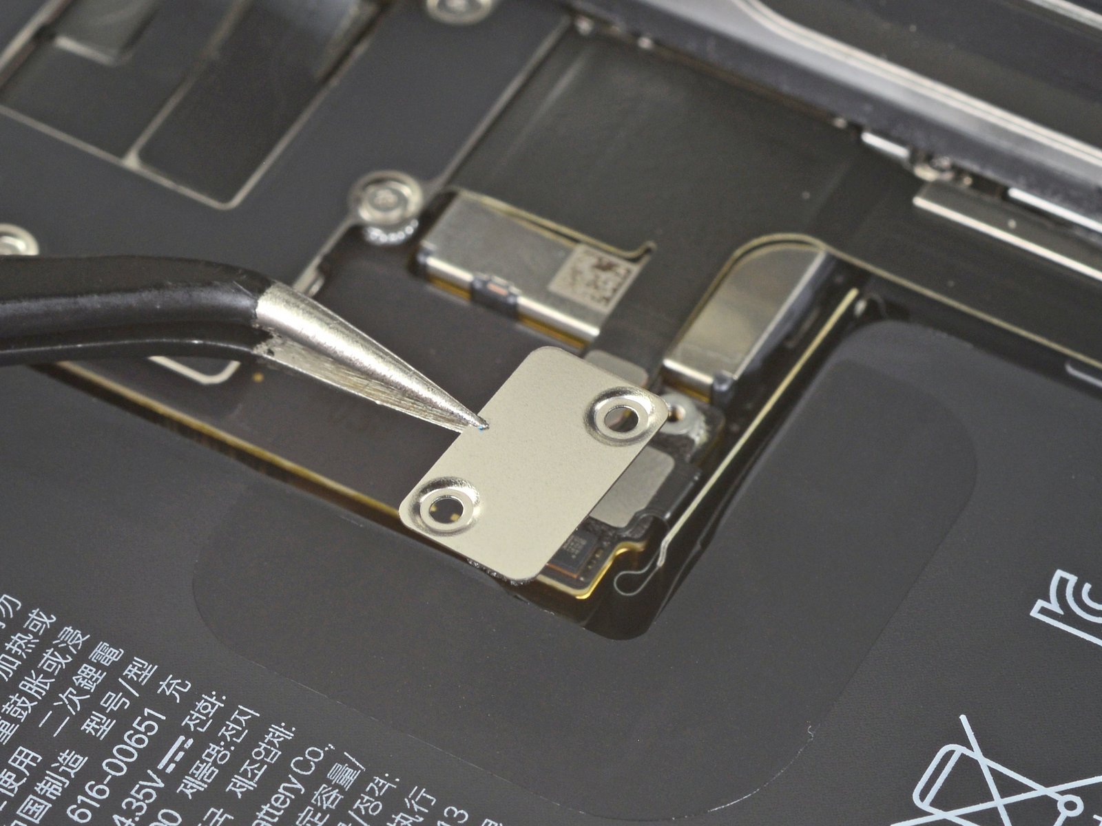

  15. 15. lépés
    Remove the battery connector cover

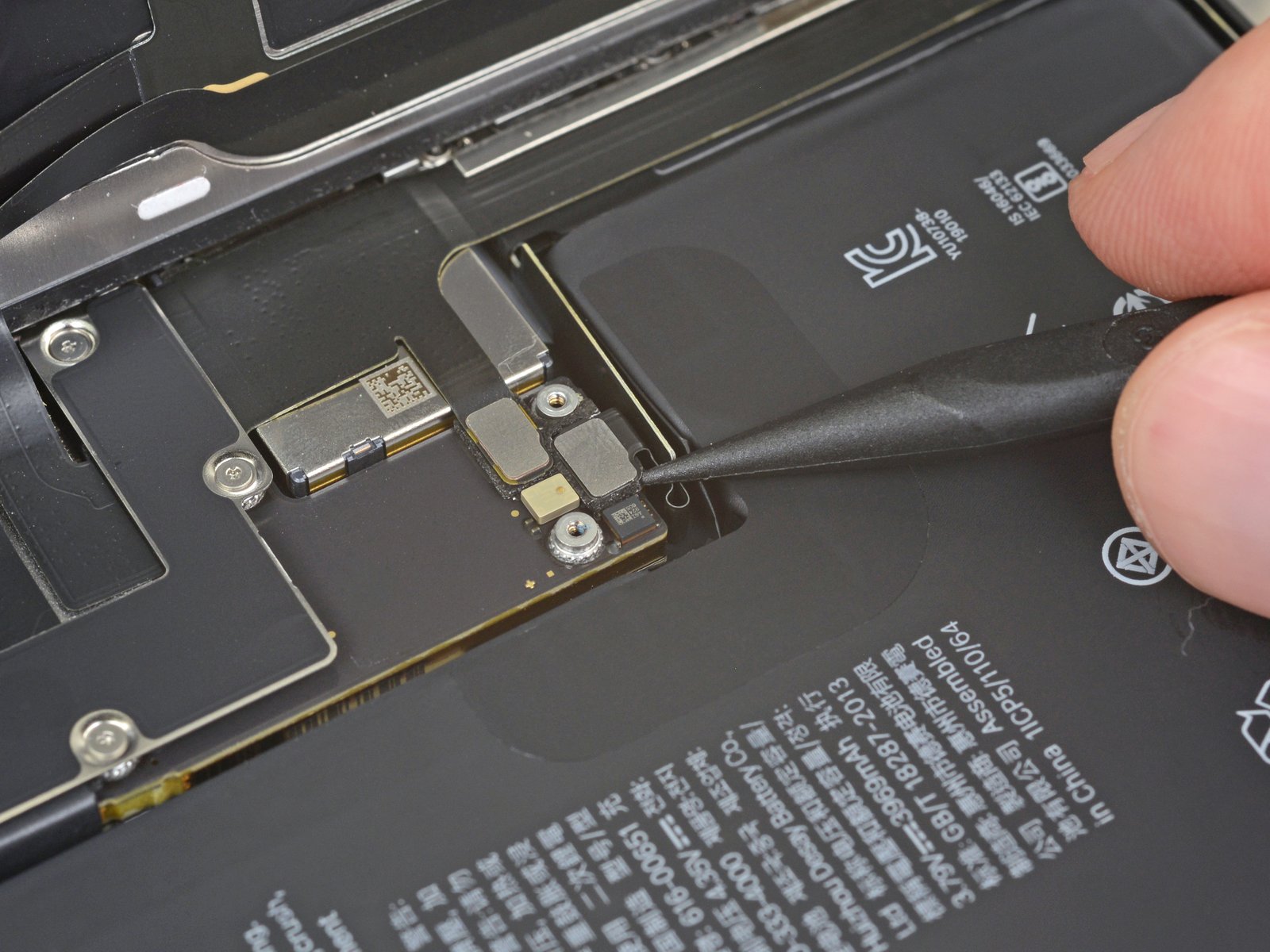

  16. 16. lépés
    Disconnect the battery

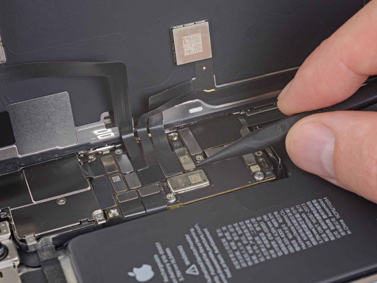

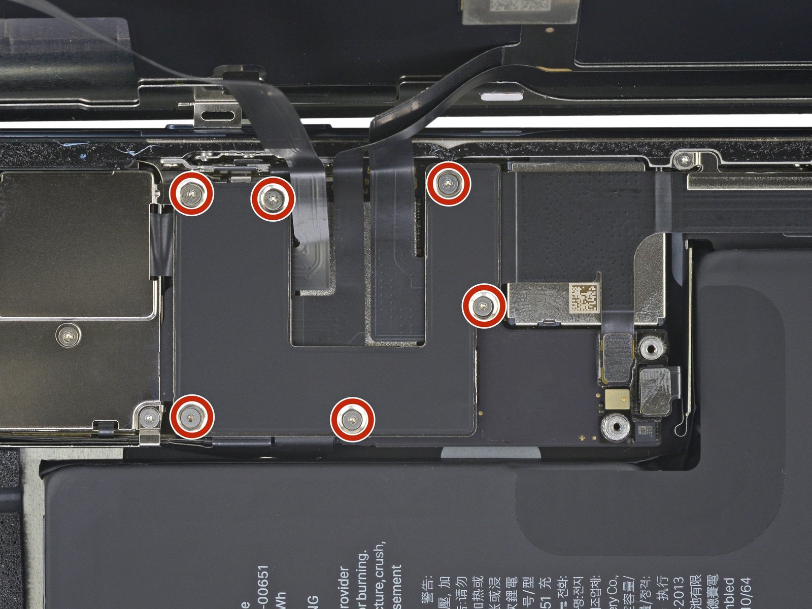

  17. 17. lépés
    Unscrew the logic board cover screws

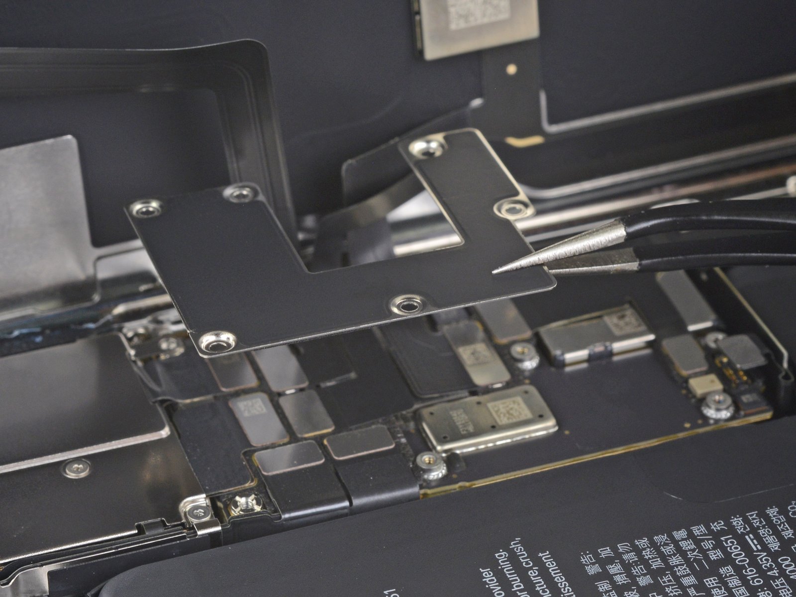

  18. 18. lépés
    Remove the logic board cover bracket
  19. 19. lépés

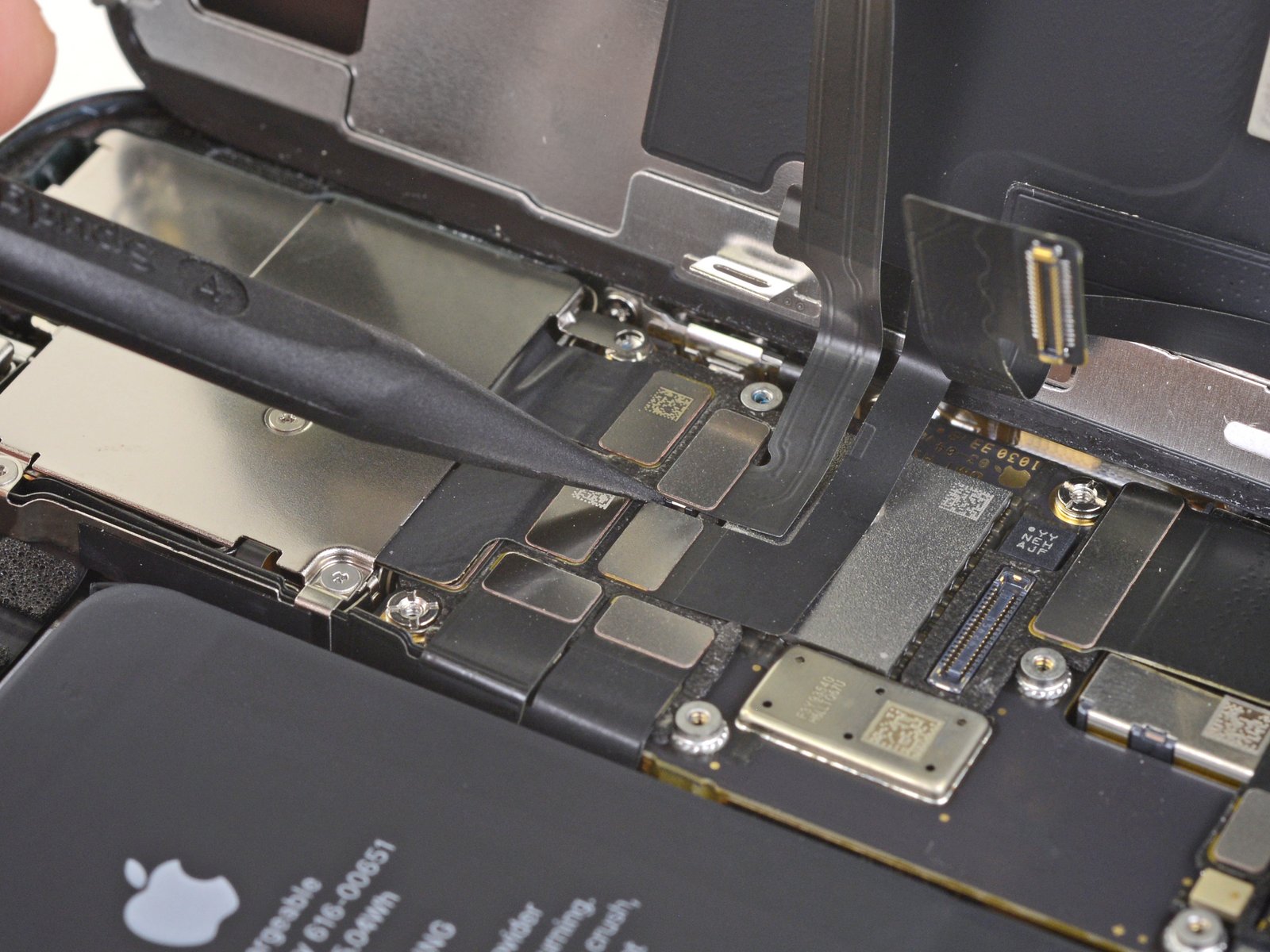

    Disconnect the OLED display cable
  20. 20. lépés
    Disconnect the front sensors + digitizer

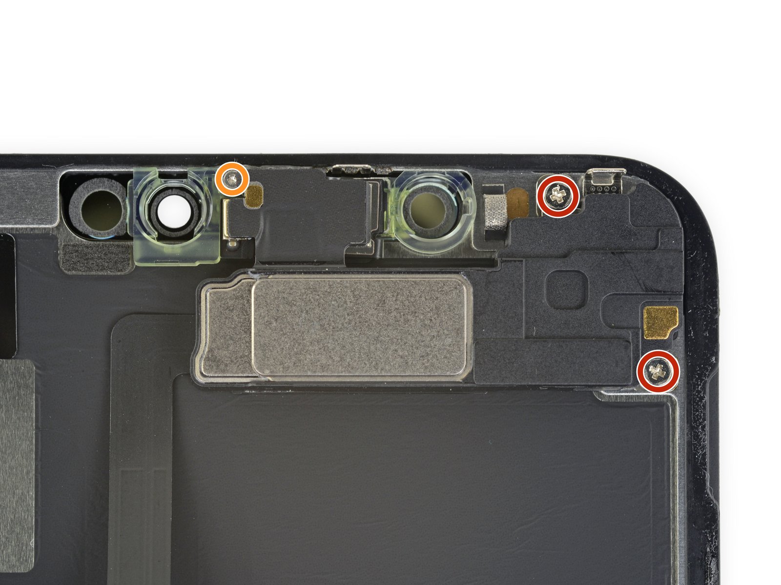

  22. 22. lépés
    Unscrew the front assembly

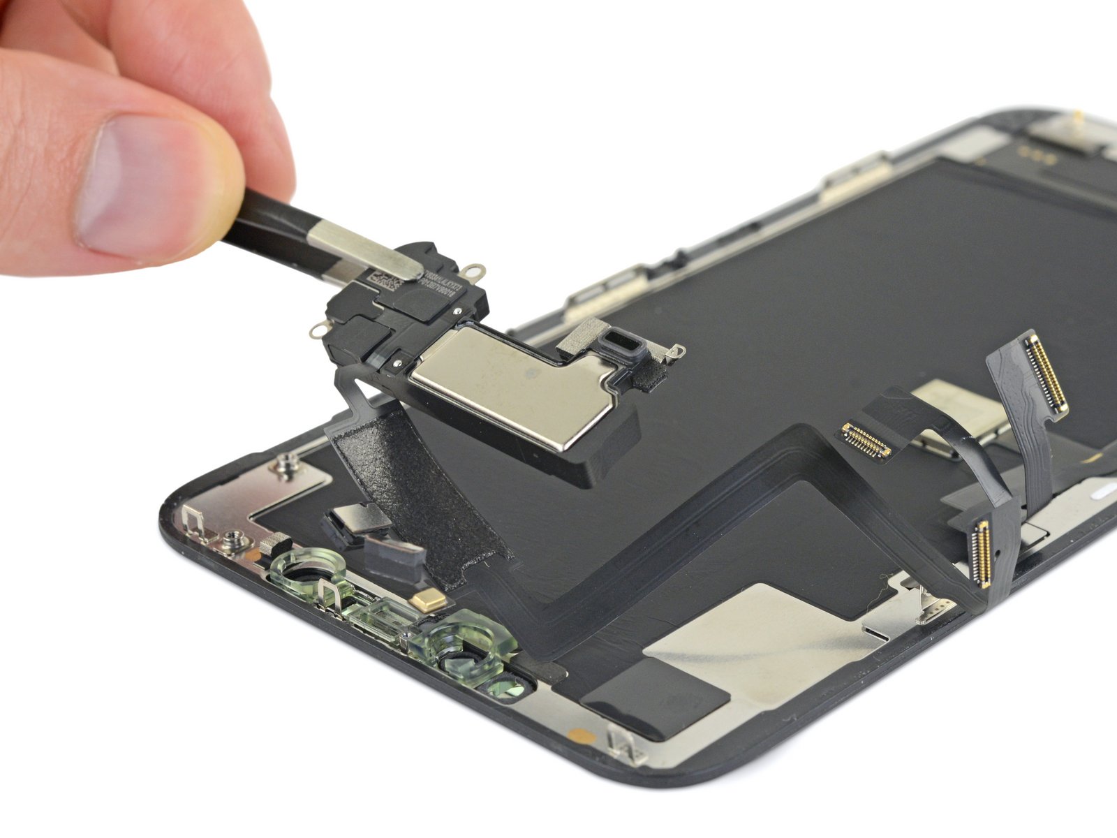

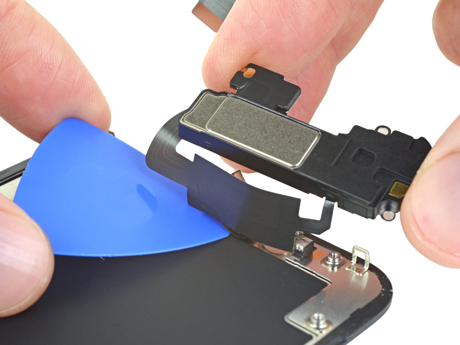

  23. 23. lépés
    Flip the speaker assembly over

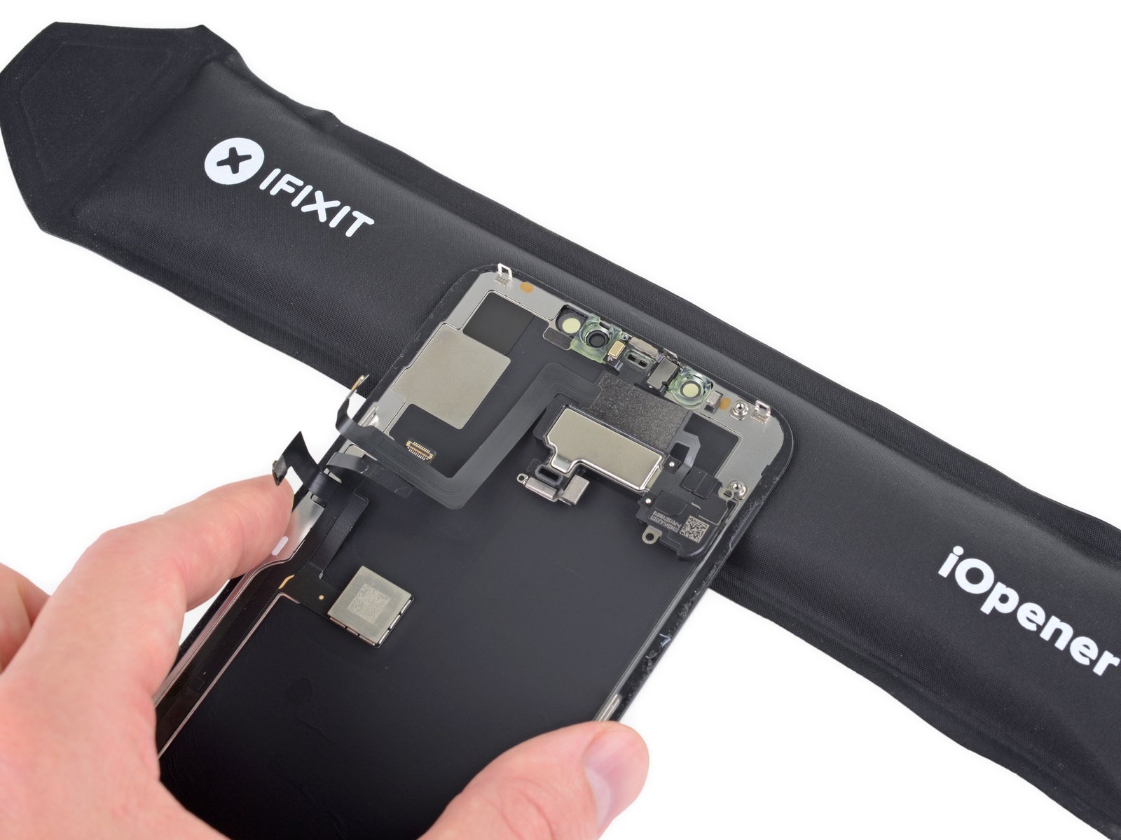

  24. 24. lépés
    Heat up the top edge of the display

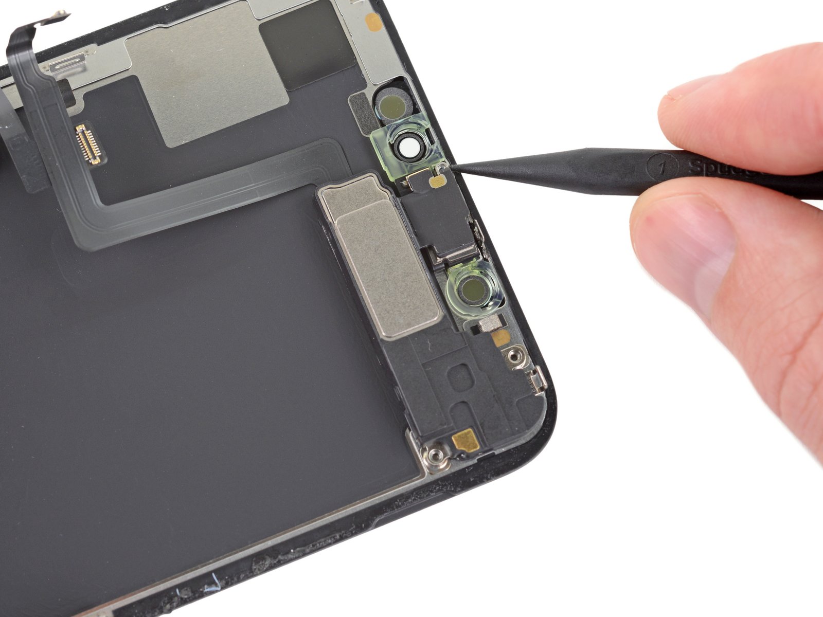

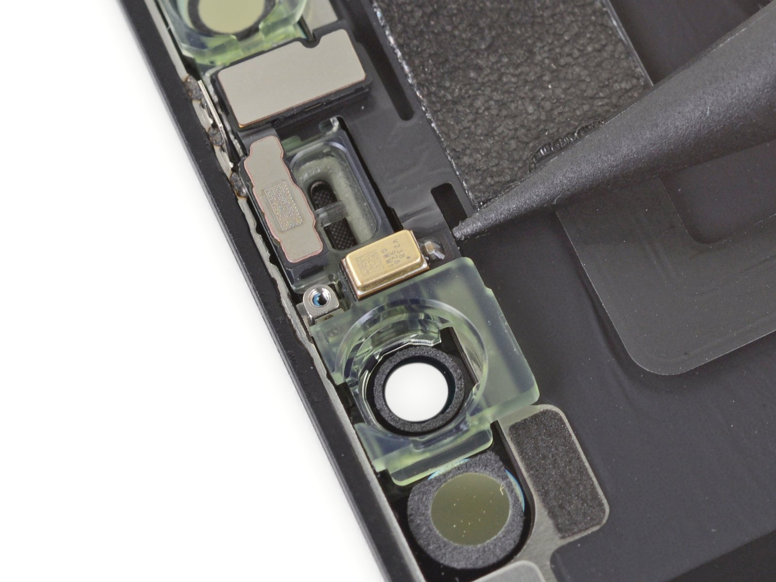

  25. 25. lépés
    Pry up the microphone

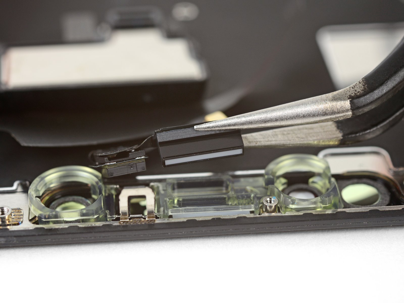

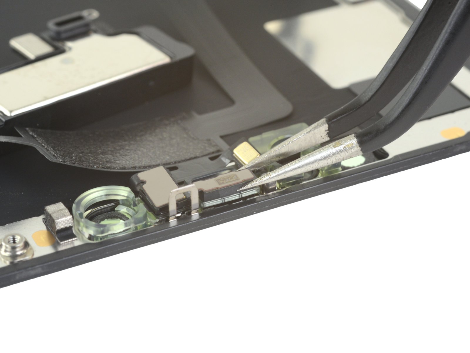

  26. 26. lépés
    Separate the ambient light sensor
  27. 27. lépés
    Title
    Title
  28. 28. lépés
    Title
    Title
  29. 29. lépés
    Remove the speaker + front sensor assembly
